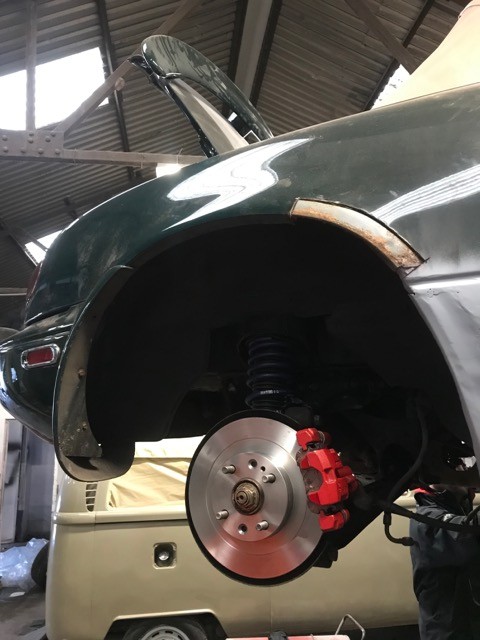

The car failed the MOT on binding brakes so need to replace the rear calipers and do discs and pads too so I think the EML light is going to be on for another month depending on if its the ECU and how much it will cost me to replace, havent had the heart to look after pricing up the 2 calipers with pads and discs lol
Contact Andrew at Autolink in Dumfries, tell him “Robin” put you on to him.
I bought 4 exchange rebuilt calipers last year, plus 4 new discs, pads, and God knows what else. Done around 2,000 hard miles with them all, and all is well. He’d need the old calipers for exchange deal. Cheapest way I know to get the job done.
cheers mate, I’ve already got 4 new calipers waiting for me to collect tomorrow at euros with discs and pads as well. Should be a nice way to spend a Sunday if the rain holds off, had to hold back from buying all new carriers and bolts off MX5parts saying to myself I can clean them up with a wire wheel instead.
