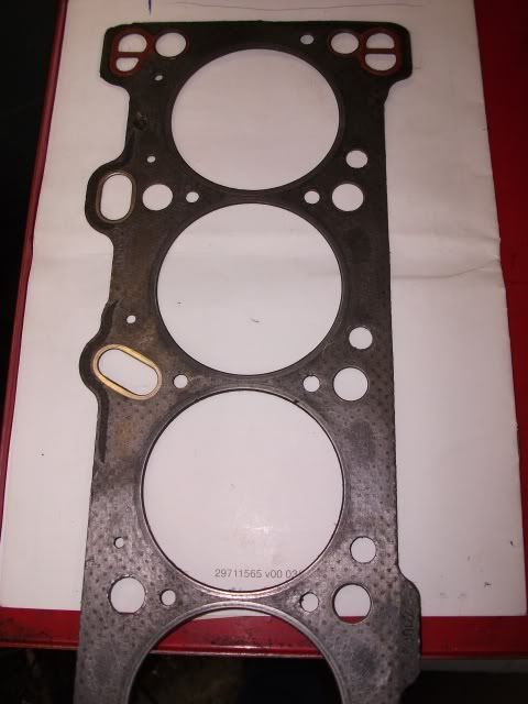

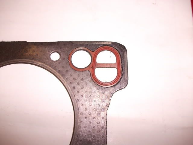

Oil leak from the exhaust side of the of the back corner of the engine on 1600’s is quite possibly the head gasket. I’ll get a couple of photos up of the cause when I can. Ones from the bell housing that are engine oil rather than gearbox oil are more likely to be from the sump gasket than the rear main.
Cheers Robbie, always appreciate your expert input and information. I will keep checking it and if I feel it gets too bad and am 100% sure where it is coming from then I may have to get it done. But it is going to be a pricey job to fix an oil leak if it is the head gasket. I did mention it to our local dealer but they dont seem to think it will be the head gasket but I just cannot see where else it can leak from having done the CAS and Cam Cover.
This image shows the head gasket, you can see the orange oil drain seals at the top corners just outside the holes for the cylinder head bolts.
Close up of the seal. They can perish with age and cause an oil leak.
Thanks Robbie, if they are at the rear of the head/block then it could explain it. Also if they are only a non pressure drain back to the sump then it should not cause any great problems and I will be able to keep wiping it clean until such time that it has to be done. I am rather loath to have it pulled apart when it is actually running fine (touch wood).
