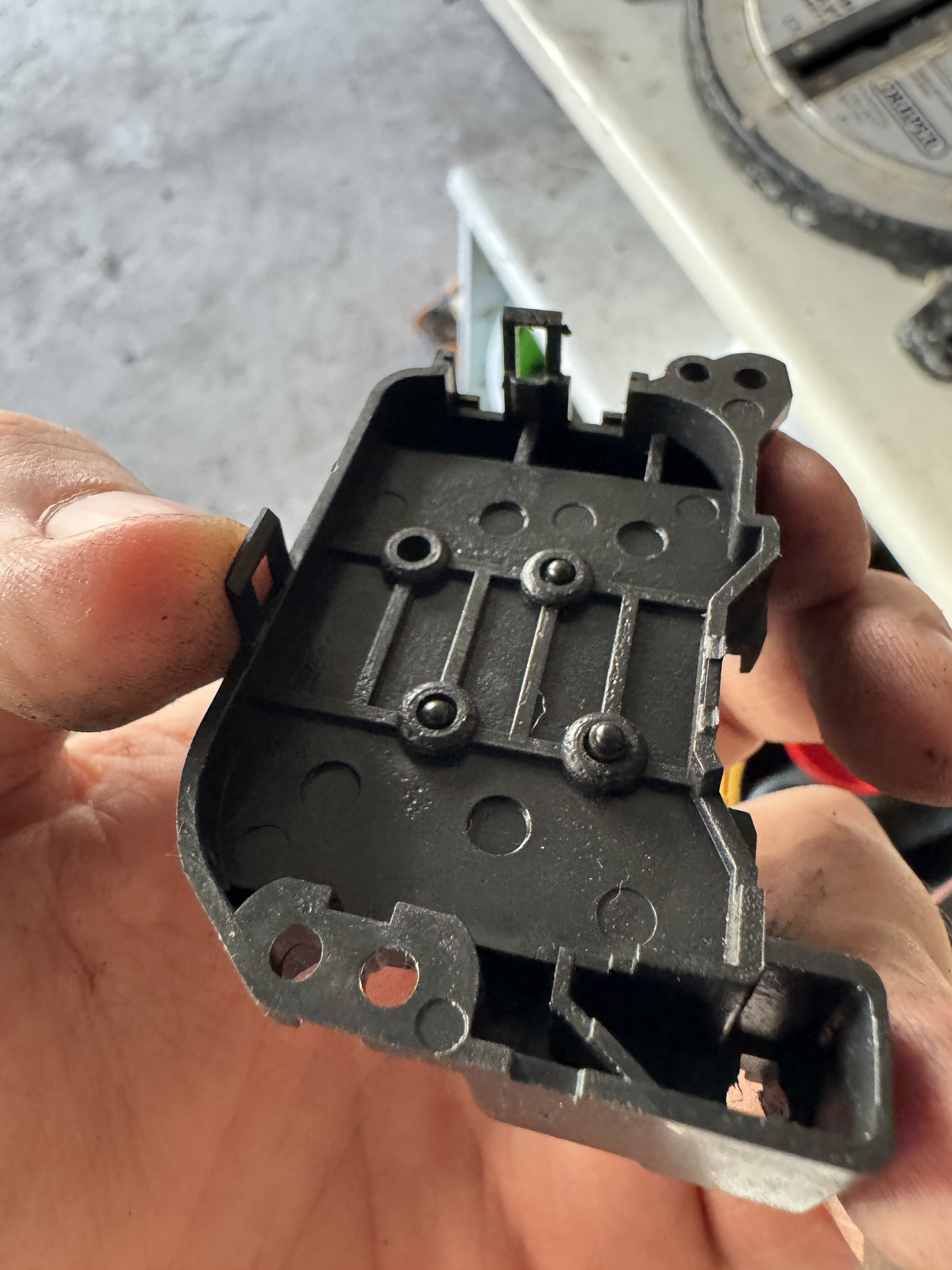

  3. I’m looking for technical help or recommendations on: my 1990 NA has a strange issue where if the weather is hot (above 20 degrees) the headlights pop up with full beam and drain the battery…
It seems to be the indicator stalk being somewhat loose and triggering a switch? But this is the 2nd set of stalks I’ve tried and the same problem occurs, any advise is helpful :slight_smile:

It’s only the high beam, the sensitive switch? Is the flash towards the driver I’ve taken an old stalk to pieces to see if I can work out what it could be and feel like it could be one of these guys expanding with the heat
Seems unlucky to get 2 stalks with the same issue though. What’s the detent for the switch like? I’d be looking at sorting the “loose” switch issue next to at least rule it out.

If I push it back towards the car yes, it’s like it’s triggering the flash switch slightly, can’t replicate today as it’s not that hot today in comparison :confused:
