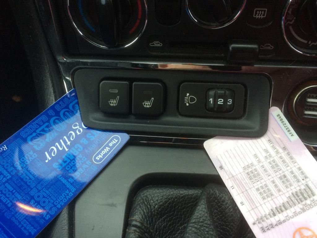

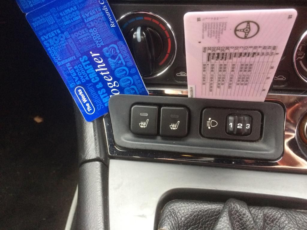

I found it easier to slip the gear stick into 4th gear to give some room. Then find a couple of cards in your wife’s purse, and use these to slide in behind the switch cowl. They will need a positive shove but you won’t do any damage.
Then work your way around the cowl. Slowly teasing it out as you go.

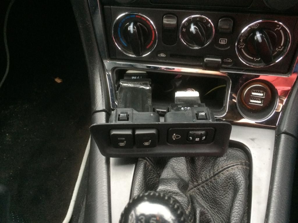

Here you can see I have removed the switch.

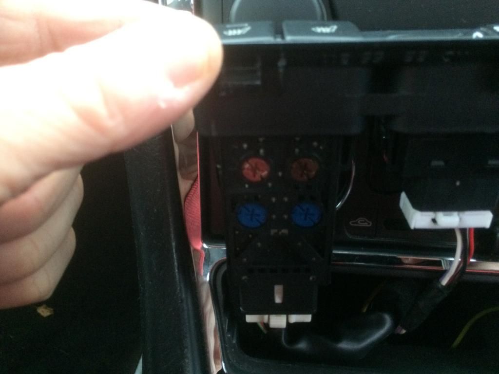

Then on the underside of the switch you will see 4 lamps. (2 brown & 2 blue)
Brown is the switch illumination
Blue is the switch indication (on)
You can see I have already changed the one on the left as it is a slightly different colour.

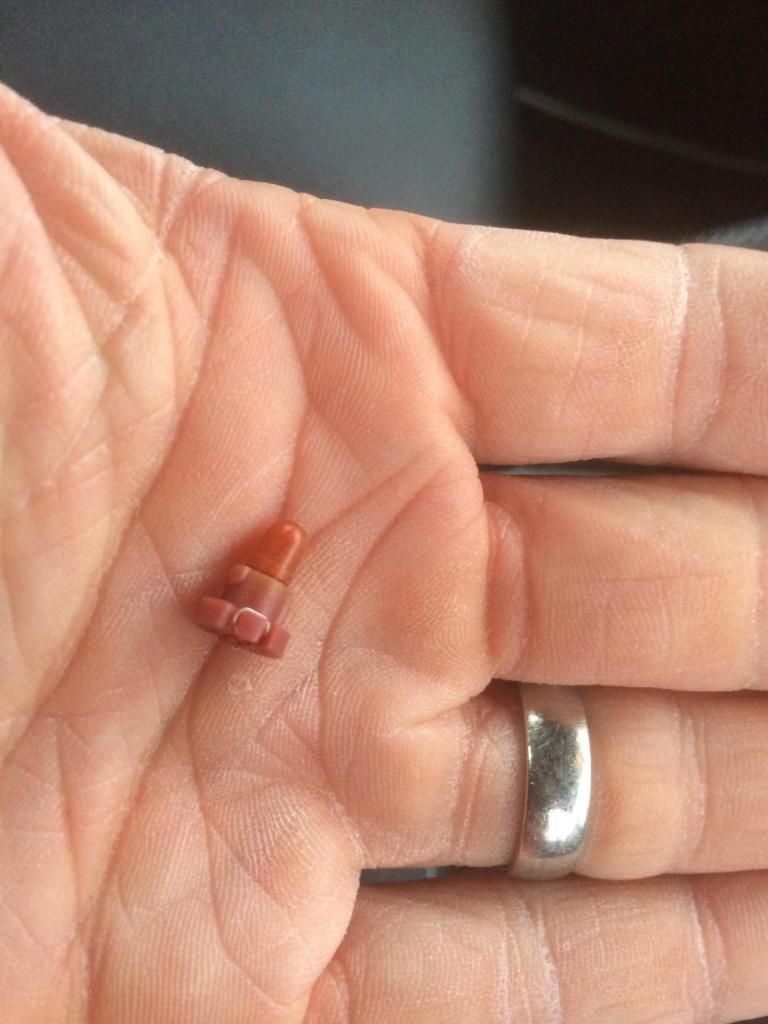

The lamp is removed by a quarter of a turn then it will fall out. Here is the lamp. When you buy it, it has a clear lens. I carefully removed the amber ‘condom’ from the blown lamp and pushed it back onto the new one.
Then test prior to replacement.
Job done.
