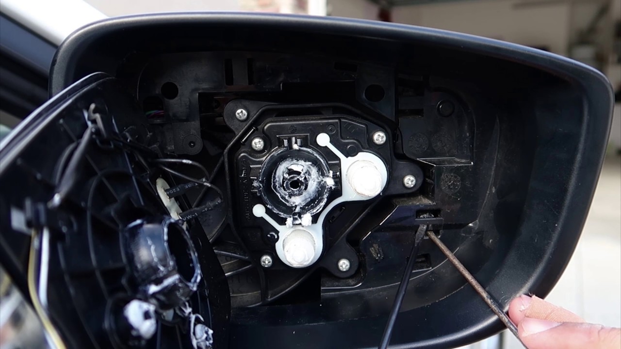

OK I’ve checked the mirror for powered movement and that is fine, so there is a supply reaching the unit. How do I get inside to check connections? :thinking:
I prised the mirror glass off my last NC drivers side mirror. It’s just clipped in if I remember correctly on a central pivot. It’s a bit daunting to do but it released. It was a little clicky in it’s movement, didn’t achieve much so put it back.
So you can have a look behind there for faulty contacts otherwise it’s the main connection loom in the door jamb.
Exactly what @MickAP said, this video might help as it is the same mechanism behind the mirror:
