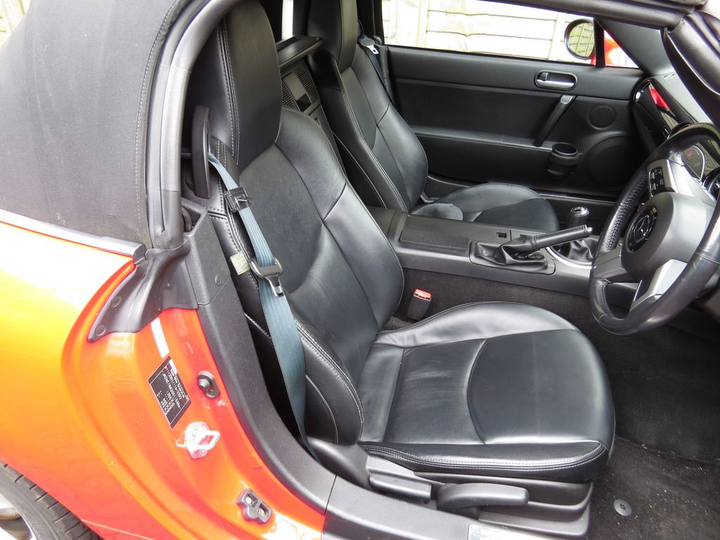

I have a 2006 NC, hated the original seats ( £50 on Gumtree is anyone is looking for some ) I bought a set of 2010 Mk3.5 (?) leather seats with adjustable height on drivers side. They drop straight in with no mods or effort. Also, I bought a set of RX-8 switches, and turned the seat logo 90 degrees - these are a straight fit into the existing wiring that is already there ( you have to cut a hole in the panel - but this is easy as the panel has a template on the back ) and the heated seats work just fine ! The height adjuster I would say at lowest is where the standard seat would be and adjusts upward which is what you are looking for  ( I know as my head touches the roof when I do ) Easy job

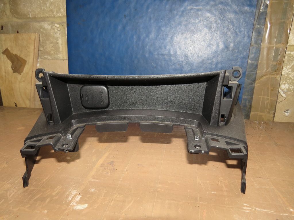

My NC had the cloth seats, not heated. The panel where the cigarette lighter ( auxiliary 12V socket is ) was plain. If you remove this panel ( dead easy ) you will find the wiring connectors attached to the back of the panel just as if there were switches fitted … hang on I have a spare panel I bought for when I sell the car - let me get it an photograph it …
Ok - So you have fitted your new leather seats and plugged in all the wires that are under the seat that are there to be plugged in on the seats ( they will only fit in specific holes so you cant really get it wrong - )  I have no airbag wiring in mine, so no issue there. Onto the interior panels and switches then
so this is the panel from the front -

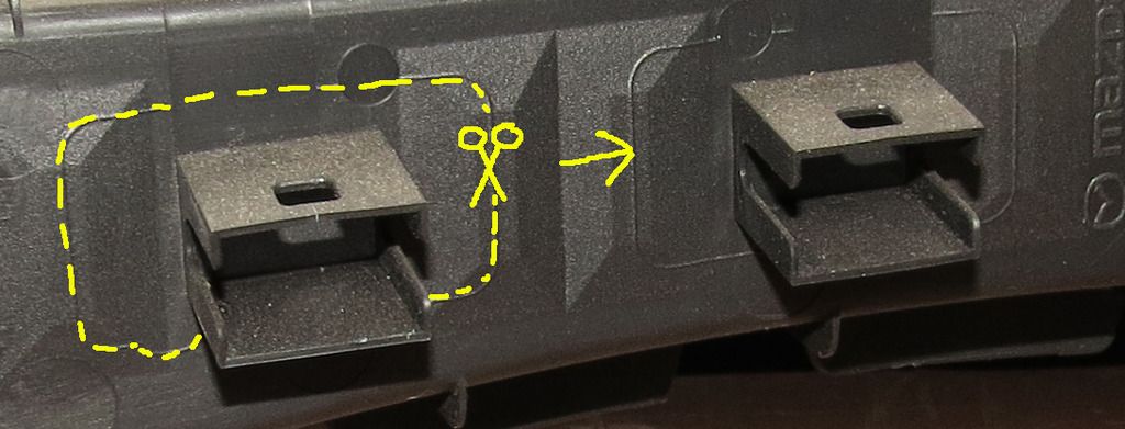

when you take it out, the connectors are on the back where they would be if switches are fitted - there is a left and right hand and they have different connectors for left and right. You can see where I have done a dotted line, this is where you need to cut out for the switch to fit. use a Dremell, or a soldering iron - keep as close to the line as you can as there isnt much room for error if you make the hole oversize. once you have cut these out - the switches should just fit straight in.

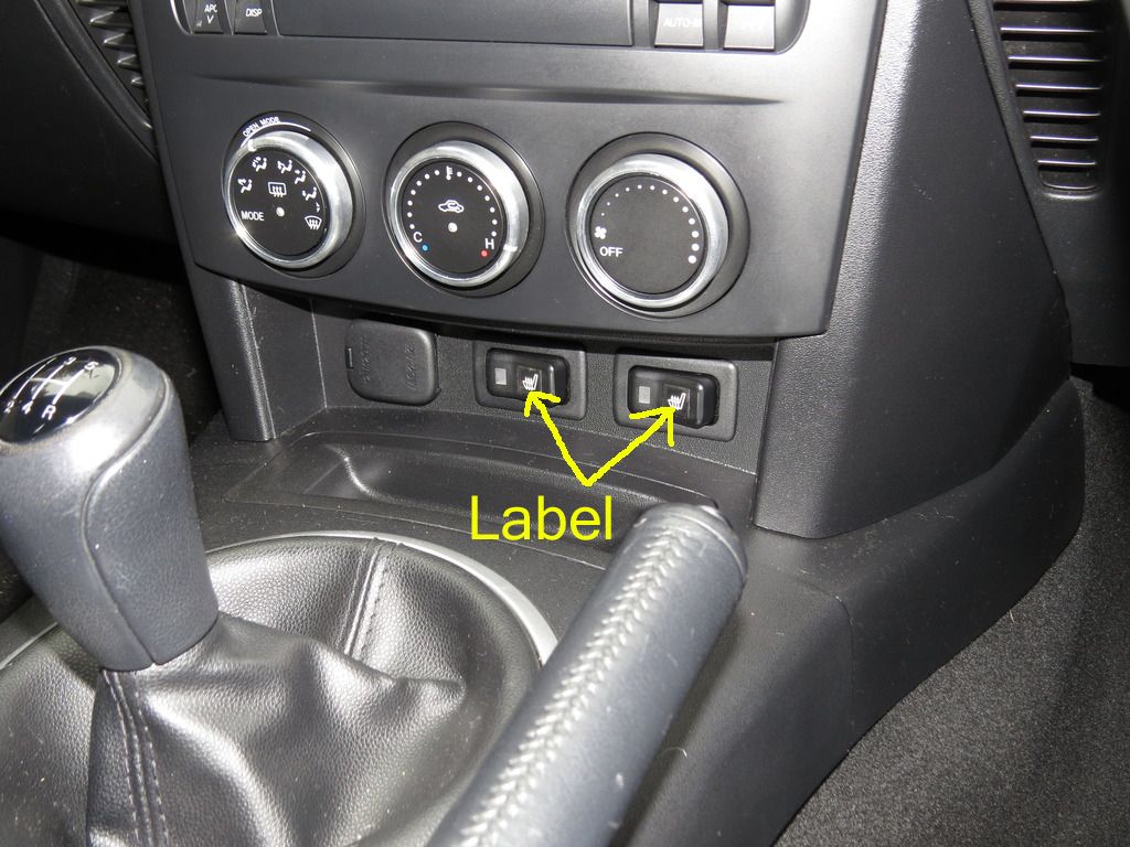

Now - I was aware that the switches in the later models were adjustable - but just assumed that they varied the voltage which restricted the amount of heat - the switches I have are just the basic on / off ones ( because A. This is what switches would have been fitted B. I’m a tightarse and didnt want to pay for the later switches ) - bear in mind when I started I didn’t have a clue whether these would work or not !  These come as a pair - this is important as they are not swoppable - you need a left and a right switch or the connectors won’t fit (the connectors are different colours from memory - black and white to match the switches)
Now - you CAN buy a set of Mazda MX-5 switches - these cost about £30 … or if you are smart ( and not a lot of people know this, in fact I couldn’t find anyone who knew before I tried ) the Mazda RX-8 switches are THE SAME, and cost about a tenner !! … BUT, because they are mounted vertically, the seat symbol is 90 degrees out - so you need to carefully prise off the seat label (shown on the picture - I did it with a scalpel … no I am not a surgeon) and stick it back on in horizontal fashion ( they are self adhesive so if you are ultra careful it pops out and pops straight back on - try not to touch the back and peel off SLOWLY so as not to ruin the logo )
So now you have your RX-8 switches fitted, and the wires connected - you just put the panel back, switch it and get a lovely warm bum and back - I assume its just the same as setting the later switches to full ? well - it certainly works for me.
Hope thats useful … seats look like this
