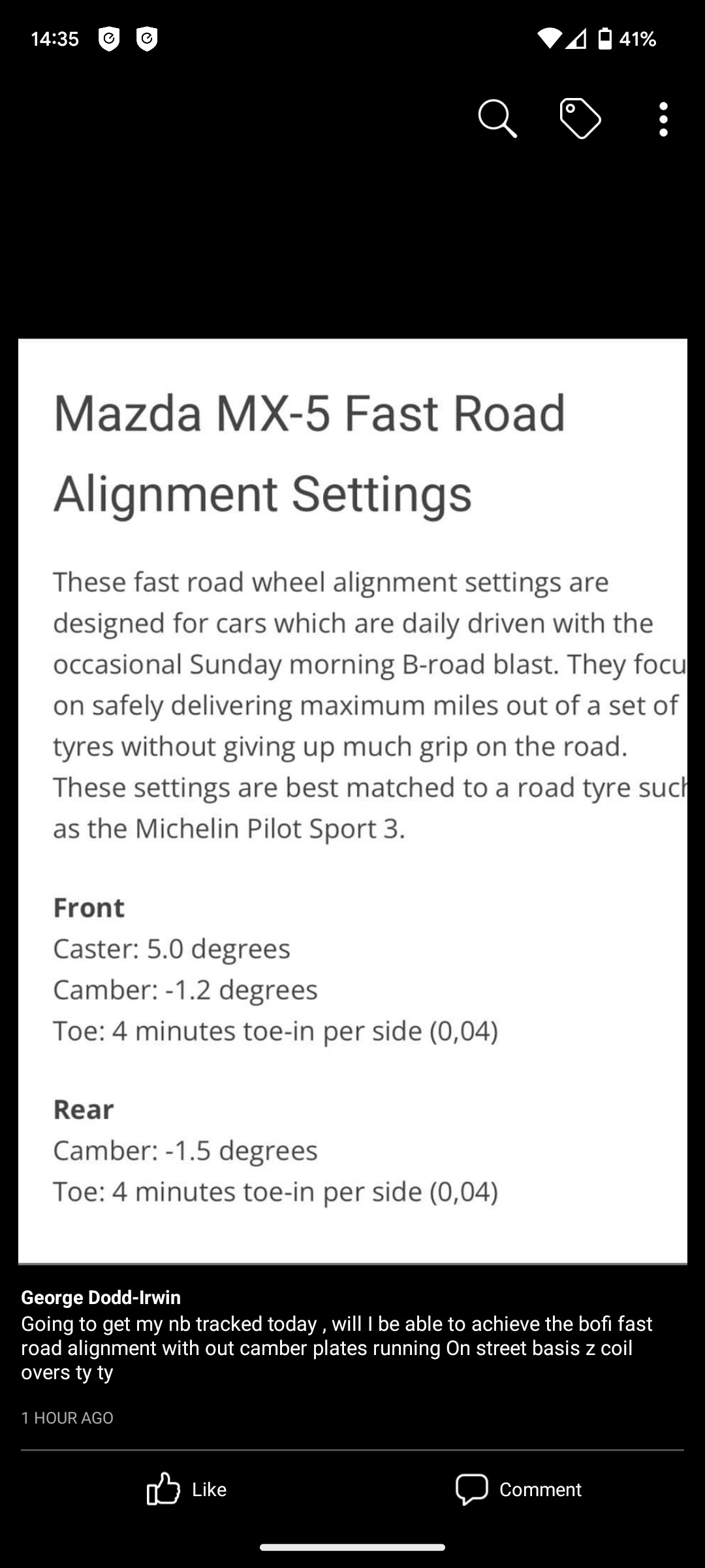

I’ve got some alignment settings from the Bofi website (see screenshot) are those numbers best for standard wheels or will they work with the wider wheels?
Does anybody else have this set up and what have you done to bring the handling back to what it was, or better?
