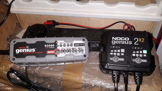

Nocos always start at the red flashing beginning and work through the testing stages. Give it a minute or so to see if it progresses through the 25% (red flashing) 50% (yellow flashing) 75% (Green flashing) to 100% green steady.
Here are some pictures of Nocos I use depending on requirement.
Noco 3500 and Noco 2+2
(normally on the 2+2 as it takes less from the mains on standby than either of the other two!)
Noco 1.
It took a minute to work through to green just now on a fully charged battery.
