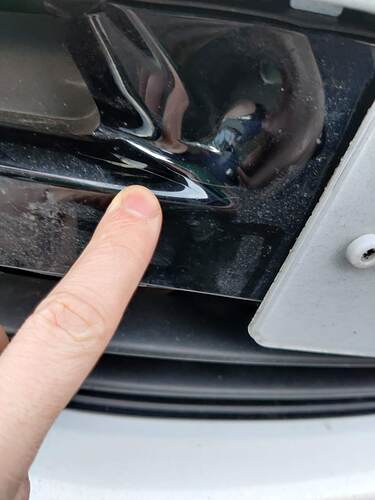

New issue: Remember how I said the Active Bonnet System light was intermittently flashing? (See pictures) I believe that its been hit whilst parked up at the garage or in the overflow car park (active pub), causing said flashing dash light.

Oh wow! thats quite the light show you have there!
Yeah, it wasn’t the last time either :see_no_evil:

You should probably notify your insurance company, even if you don’t end up making a claim it’s best that you tell them sooner than later if your car is damaged.
Ohh god, do I really have to? Read some horror stories on this forum about telling insurance companies about any slight damage.

I’d be surprised if it isn’t part of your terms for insurance (it is with my policy).
From what little I know of the active bonnet system, if it were at fault due to accident damage, I don’t think you’d want to end up footing the bill.
Still, hopefully it’s just the low battery been causing strange errors :slight_smile:
Spoke with the garage, checking CCTV to see if we can find anything.
