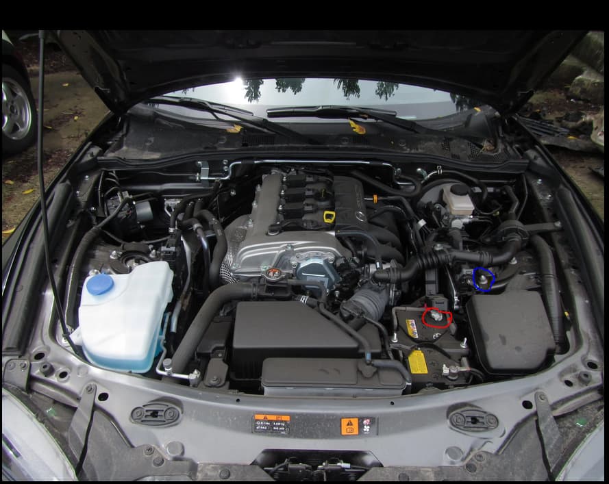

In this order: Red croc clip on positive battery point (red on pic), black croc clip on the ‘nut’, shown in blue as black pen wouldn’t show on the pic. Plug the ctek in.
When charged (or you’ve got to stop it for whatever reason. like it starts to rain etc) the reverse order: Unplug cteck, black clip off, red clip off
