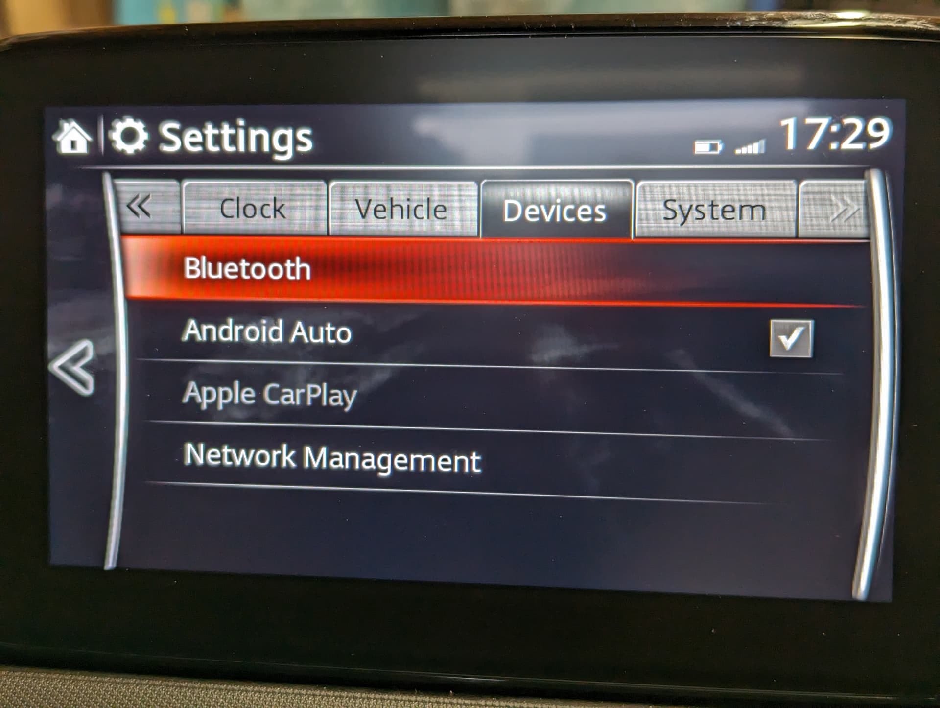

When the engine is running, is the Android auto option ticked in that menu. I accidently unticked mine the other day and I couldn’t connect?

I just double checked and I had remembered it wrong. The option under applications isn’t changable, The option to check is under Settings > Devices, and the tick box sometimes takes a few seconds to appear with the phone connected and the engine on.
