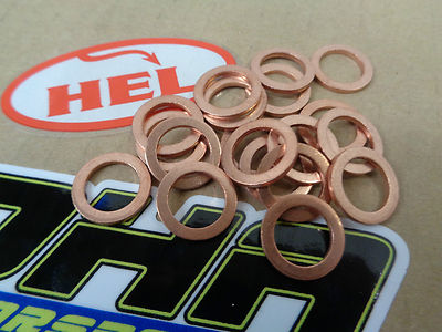

If I am keeping calipers off for any amount of time I use an M10 nut and bolt through the banjo hole to seal the system. ( I also have quite a few copper washers in the garage - they should only be used once )
