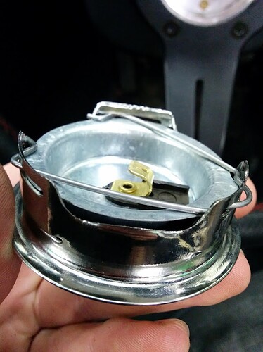

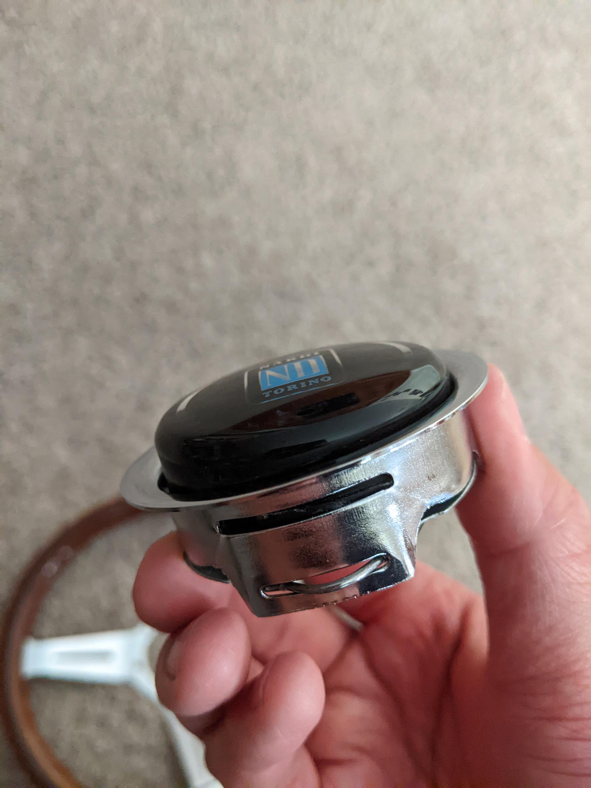

The chromed horn push will prise off; fingernails help. If you don’t want to risk scratching the metal with a small screwdriver, you can get a plastic trim removal tool, or get one of those disposable plastic dinner knives. The black trim piece is an interferance fit on a series of small bolts, using plastic inserts. These sometimes come off. I used siicone. But the horn push really secures it in place.

DO NOT PRIZE IT OFF! The button needs to rotate anti clockwise 1/6th of a turn to release the tabs.
To remove the horn switch assembly, it has to be prised off.
I have removed and fitted quite a few of these over the past 20+ years.

From the photo posted by AST it looks like the tensioned spring /wire that straddles the horn push holds the horn push tight like a wedge

AT is correct and it’s a good job I have long fingernails as thats what I started with. When you feel it start to move then use something to prise it out, i used an old flat bone handled kitchen knife and it just popped out. Power supply is via electrical spade connection and i have marked the orientation

To be fair, you described it as the horn push. So I thought you were removing the button itself not the whole assembly. I just misunderstood. I didn’t want you to break any of the plastic tabs while taking the button off the assembly.
