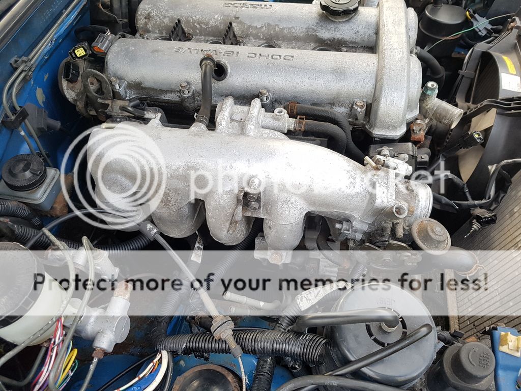

ok. This is a picture of 2 and 3 cylinders with the bottom of the picture being the front of the engine. I see dots facing the front. Does this have significance? Thanks Robbie.

That’s an early engine, the later ones have the dots on the flat part of the piston crown rather than on the dished bit.
