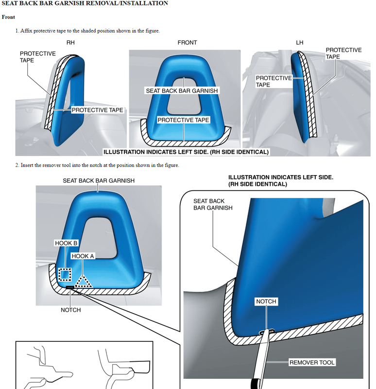

Where the NC had a small cut out to help ‘POP’ the cover out, the ND does not, I have tried squeezing the covers like you do with the NC however no movement…

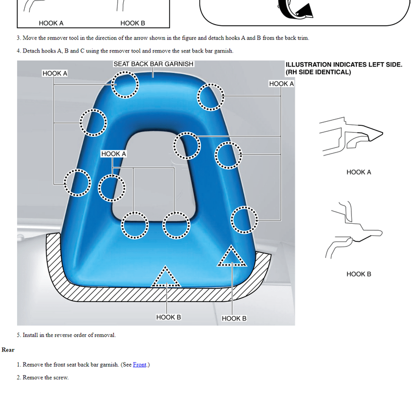

The interior side of the cover just pulls off, then the rear unscrews from inside. If you can message me an e-mail address I could probably pull the instructions out of the service manual for you.
This may be of some use:
Found via this link https://forum.miata.net/vb/showthread.php?t=606495
