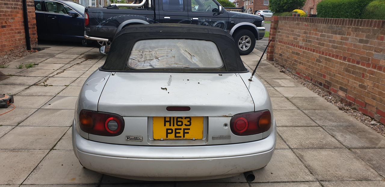

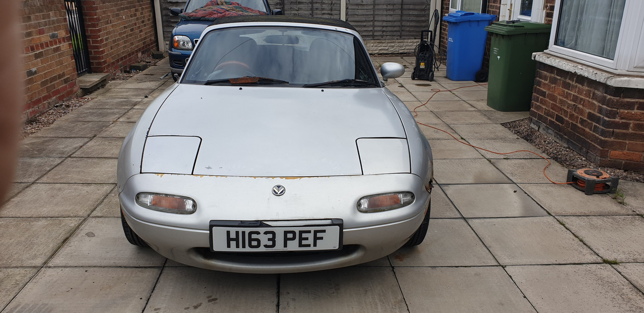

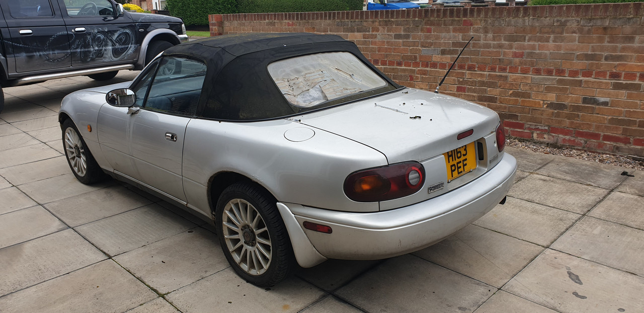

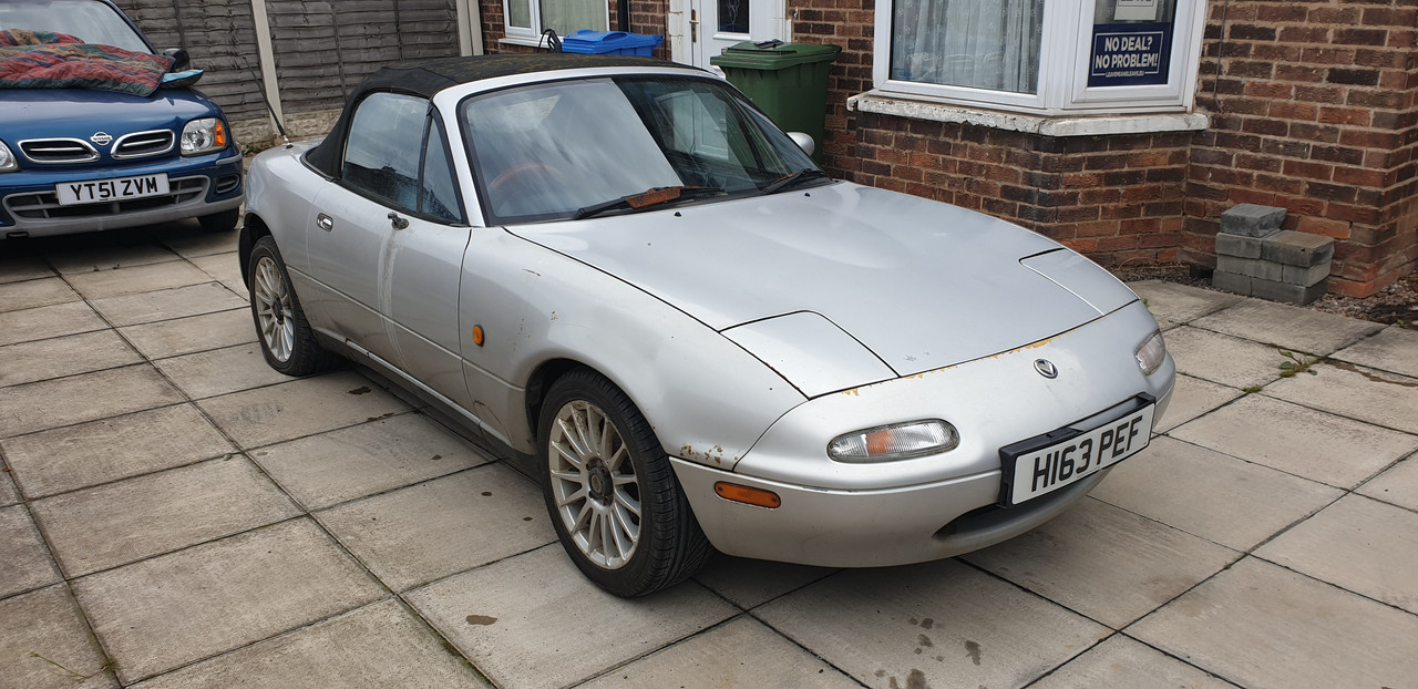

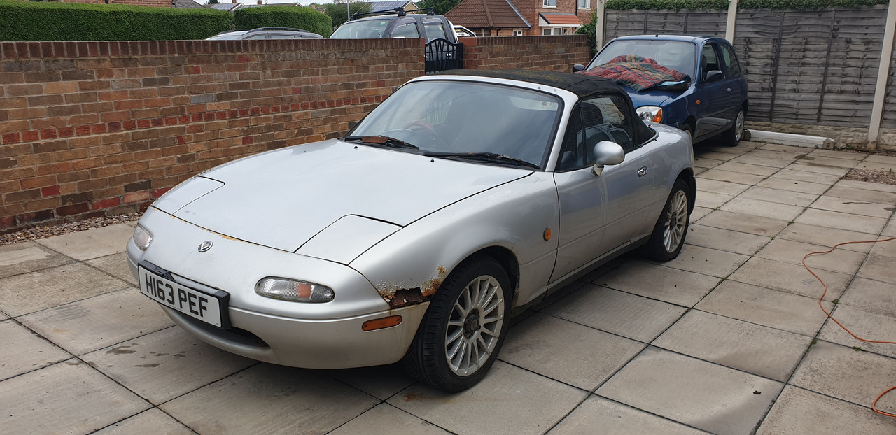

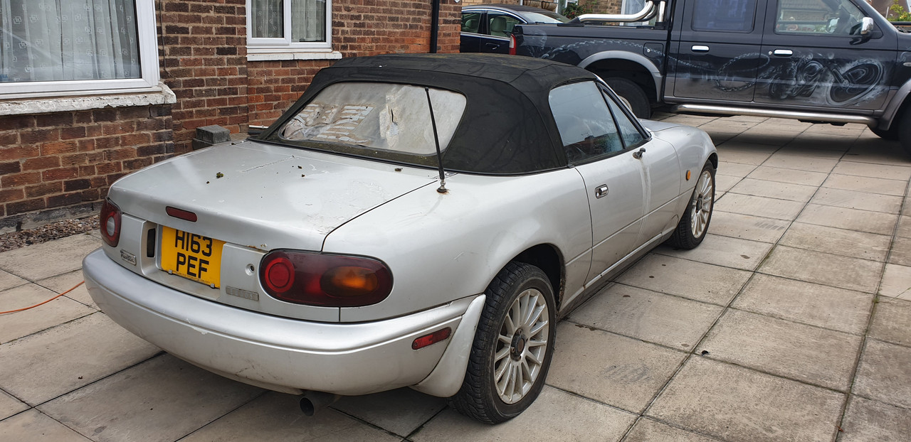

as i first saw it.
then i got it home, but didn’t have time to look at it until today because of work and heres todays photos and what iv’e found.

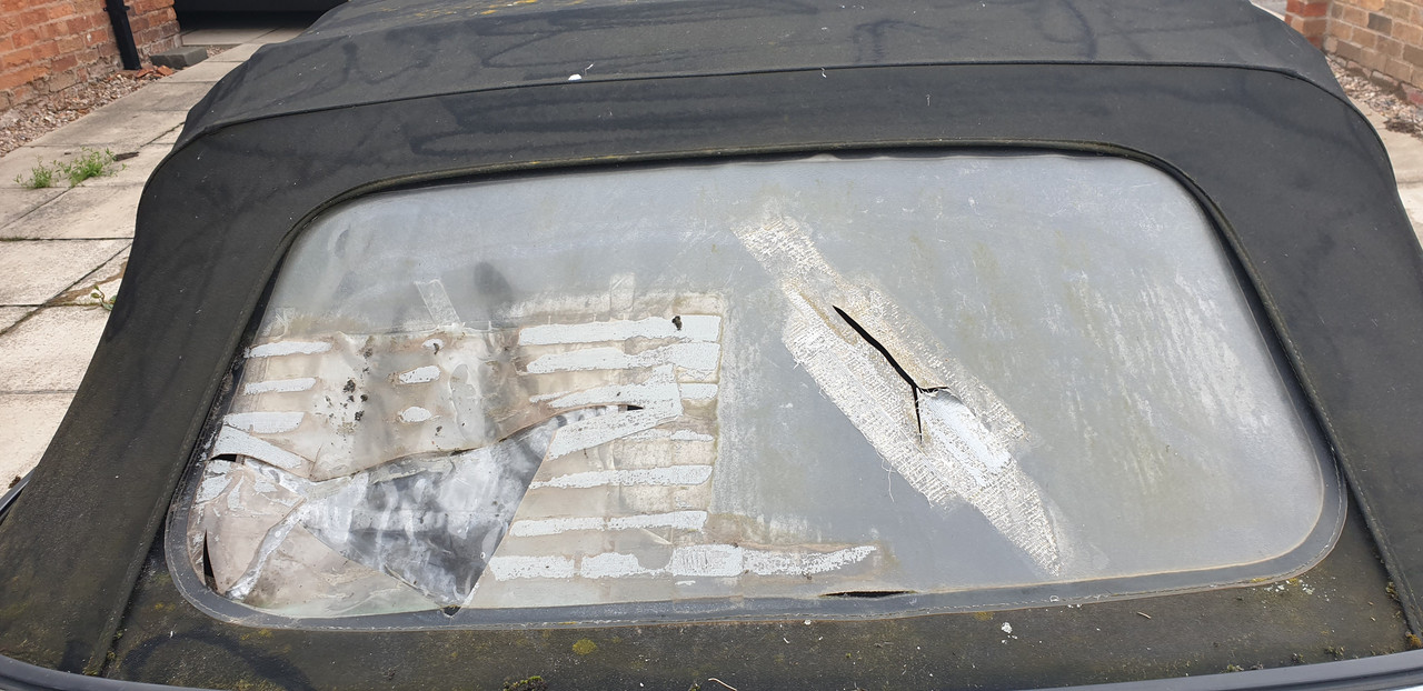

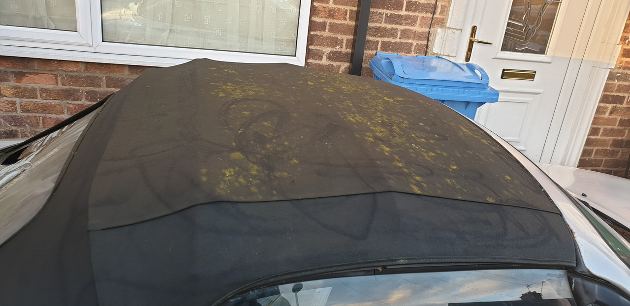

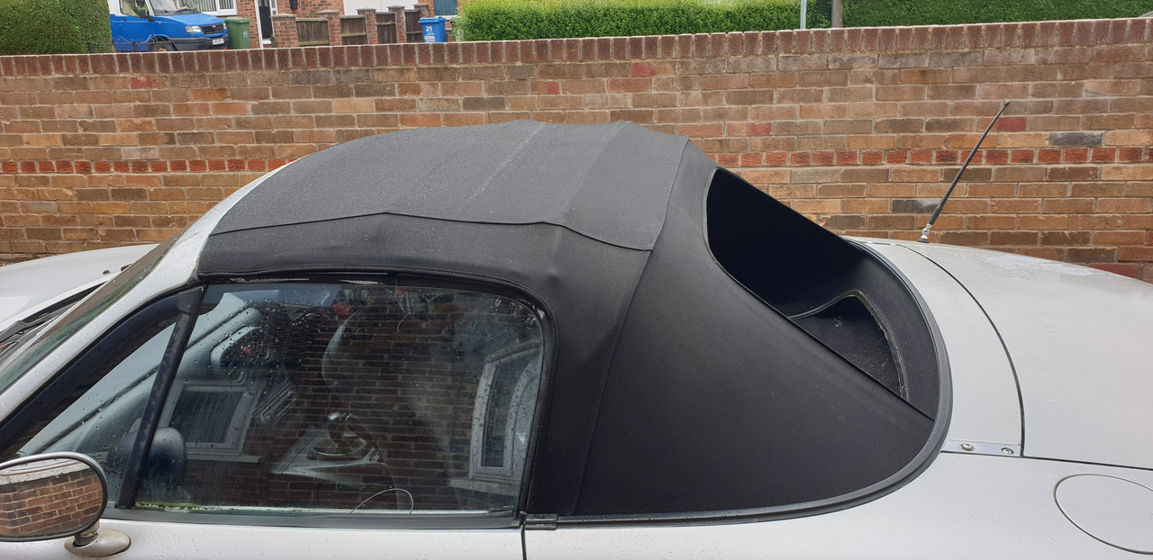

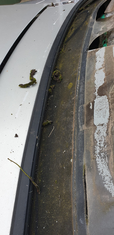

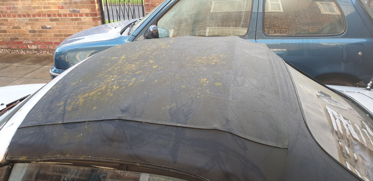

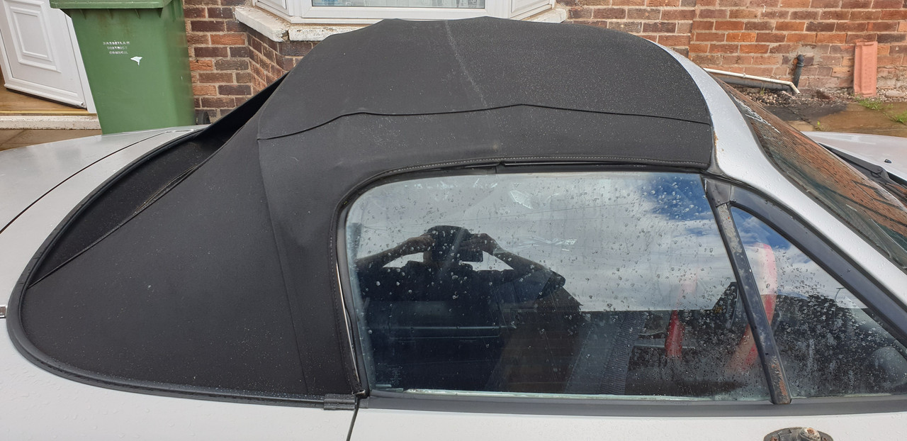

hood before cleaning.
full of green mildew and liechen
and now it’s been cleaned and sealed.

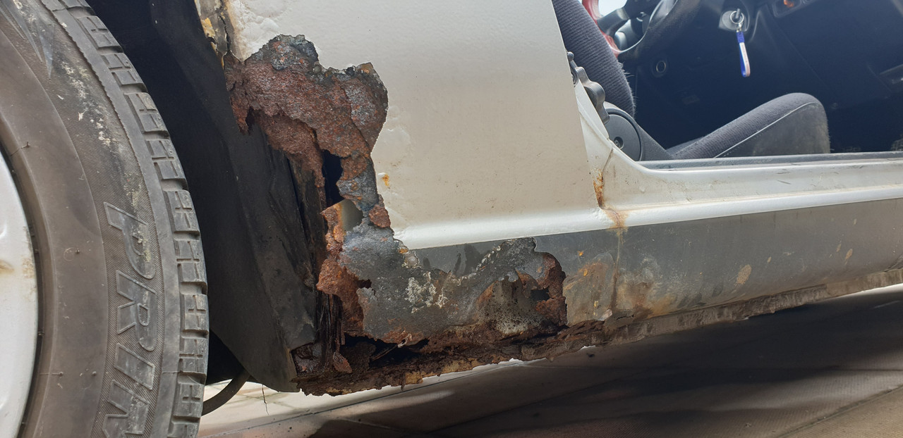

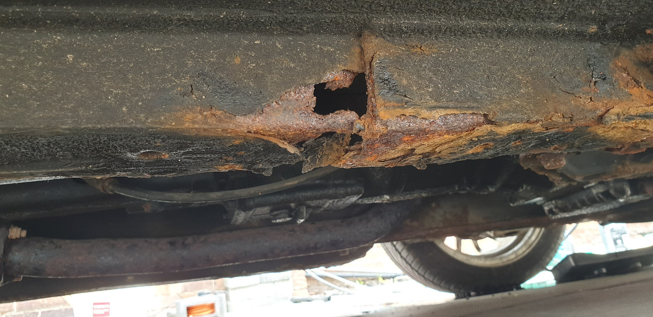

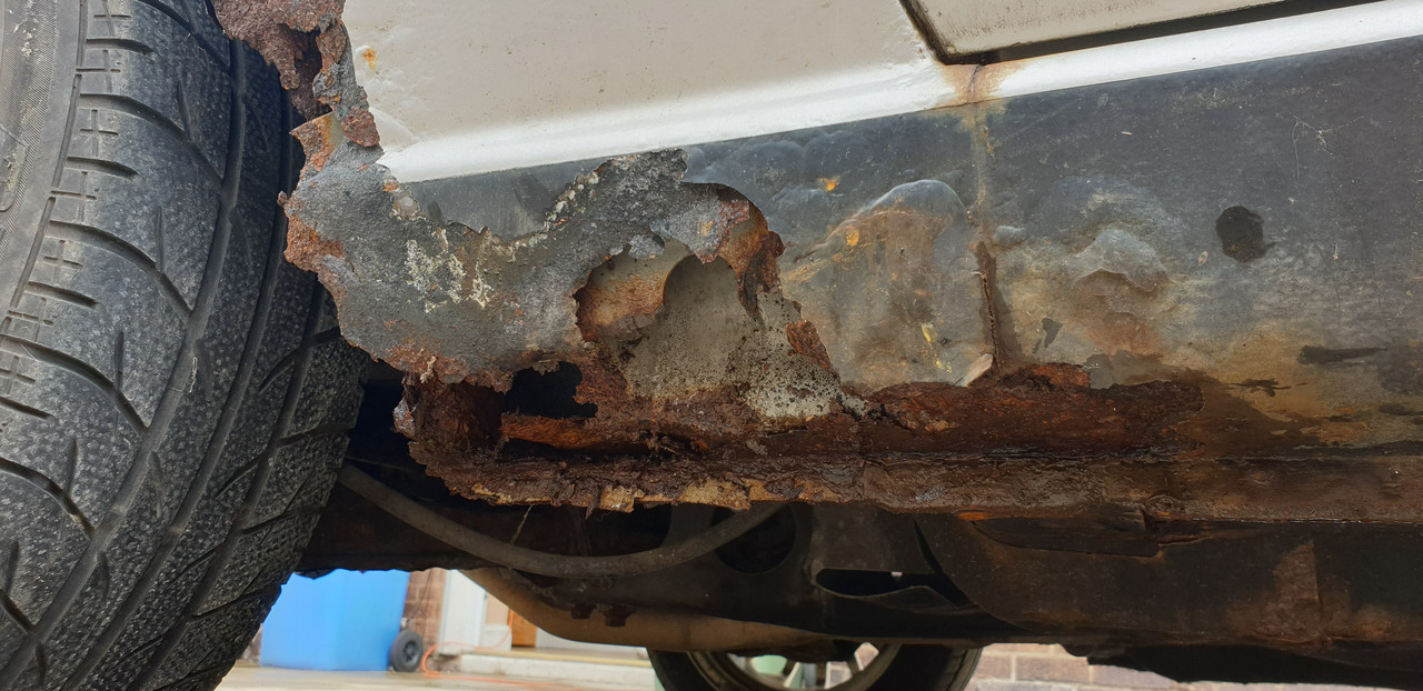

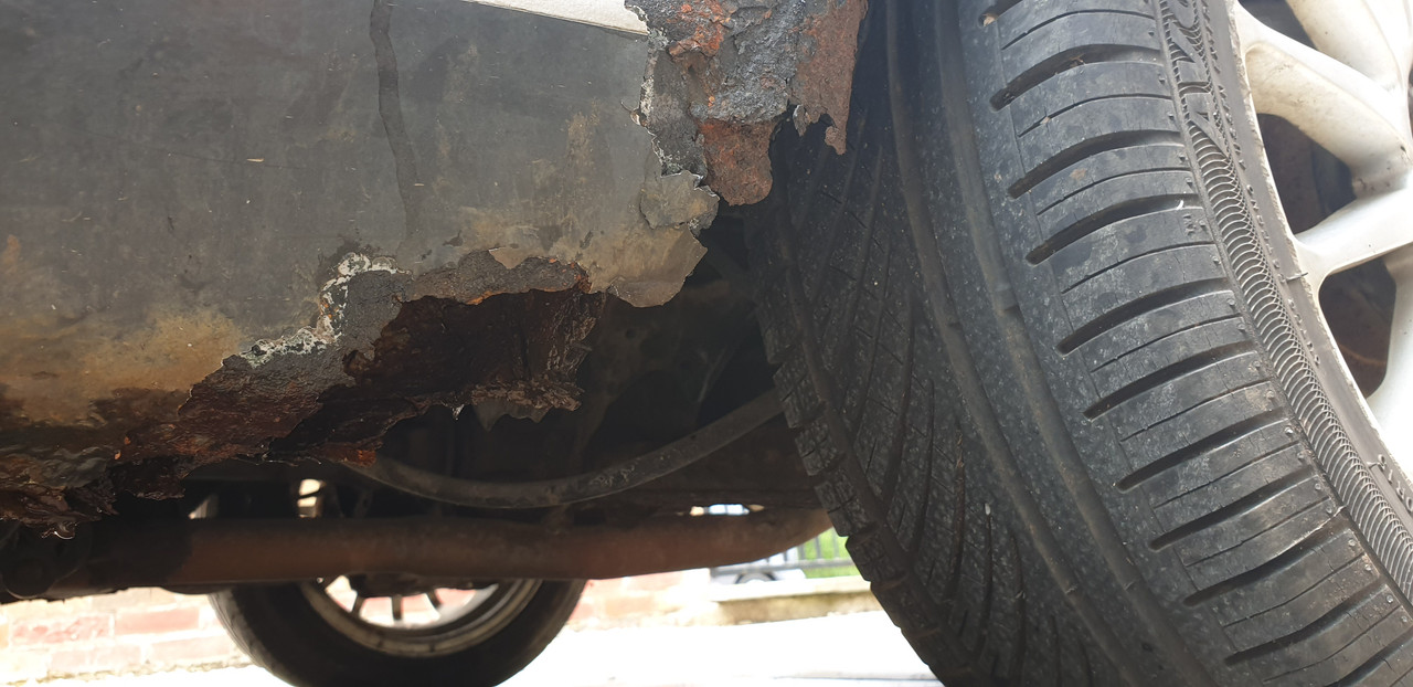

the body work is shot…theres no other way of describing it it’s fooked., starting at the drivers side wing, it’s holes in the bottom corner by the sill NEW ONE NEEDED, drivers side sill is shot, NEW SILL NEEDED,  drivers side inner sill is shot, rear drivers side sill with the over lap is holed BIG time both inner and outer, new repair section needed, wheel arch … yes youv’e got it, it’s shot. passenger side front huge hole in the front wing, new wing needed, sill the whole length shot, new sill and probably inner sill needed, passenger side chassis fram huge hole in it, needs new box section welding in, pasenger side rear sill with the overlap is … well it’s not there, new one and inner sill needed, rear arch needed…

As I said in the reply to your last thread - you have your work cut out, I hope you got the car cheap.
Unless this is a labour of love which it should not be for you as until very recently not your car and no emotional connection as far as I can see, break it for parts.
Use the experience of taking it apart to assist you in a worthwhile early Eunos project.
Hopefully the eventual sale of some of the parts will pay for your original outlay.
This car requires too much work to be a worthwhile project in my  opinion.

Mudflaps are worth saving (shortie ones are hard to get). That’s about it. The interior is trash, front wings are shot, roof dead, no one wants bumpers. Engine has a fair few miles on it. Not even sure you have £300 worth of parts there.

Must say, I’m quite impressed with the state of that front wing.
I don’t think I’ve ever seen one as far gone as that.

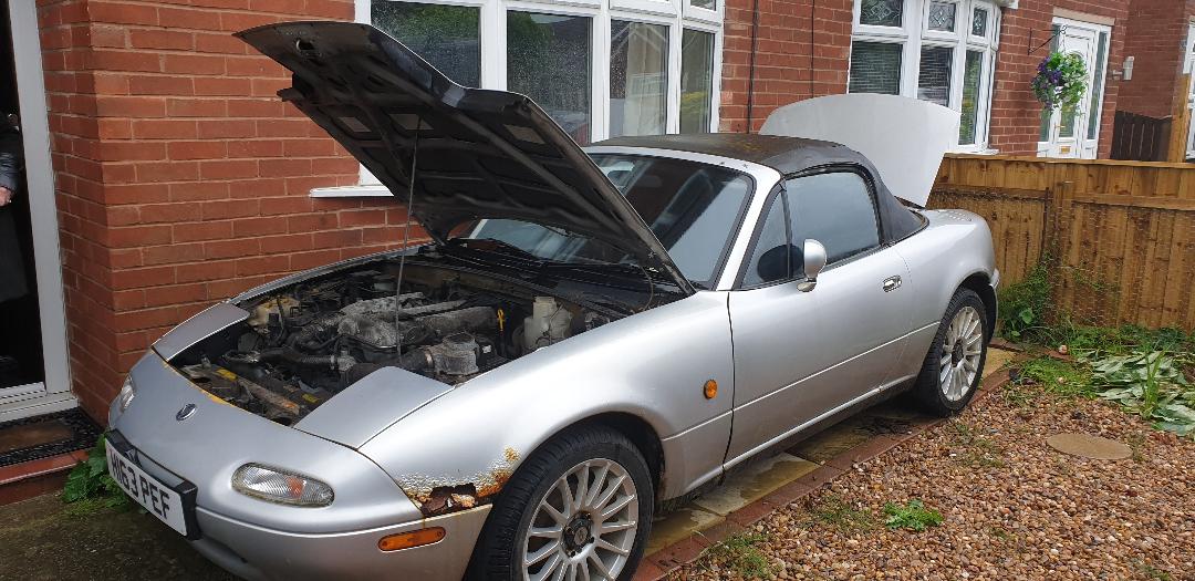

Decided to resurrect this.
I must be mad.
Your not alone lol get a look at this one its about the same state as yours but i will resurrect it.
 Run Forrest, run!!!
Waiting for my next day off and get it up on a lift, take a proper look see at the underside, I’ve restored worse mk2 cortina’s but they are financially viable, theres still a glimmer of hope, even if its just rust cut out and patched until time and finances agree.
