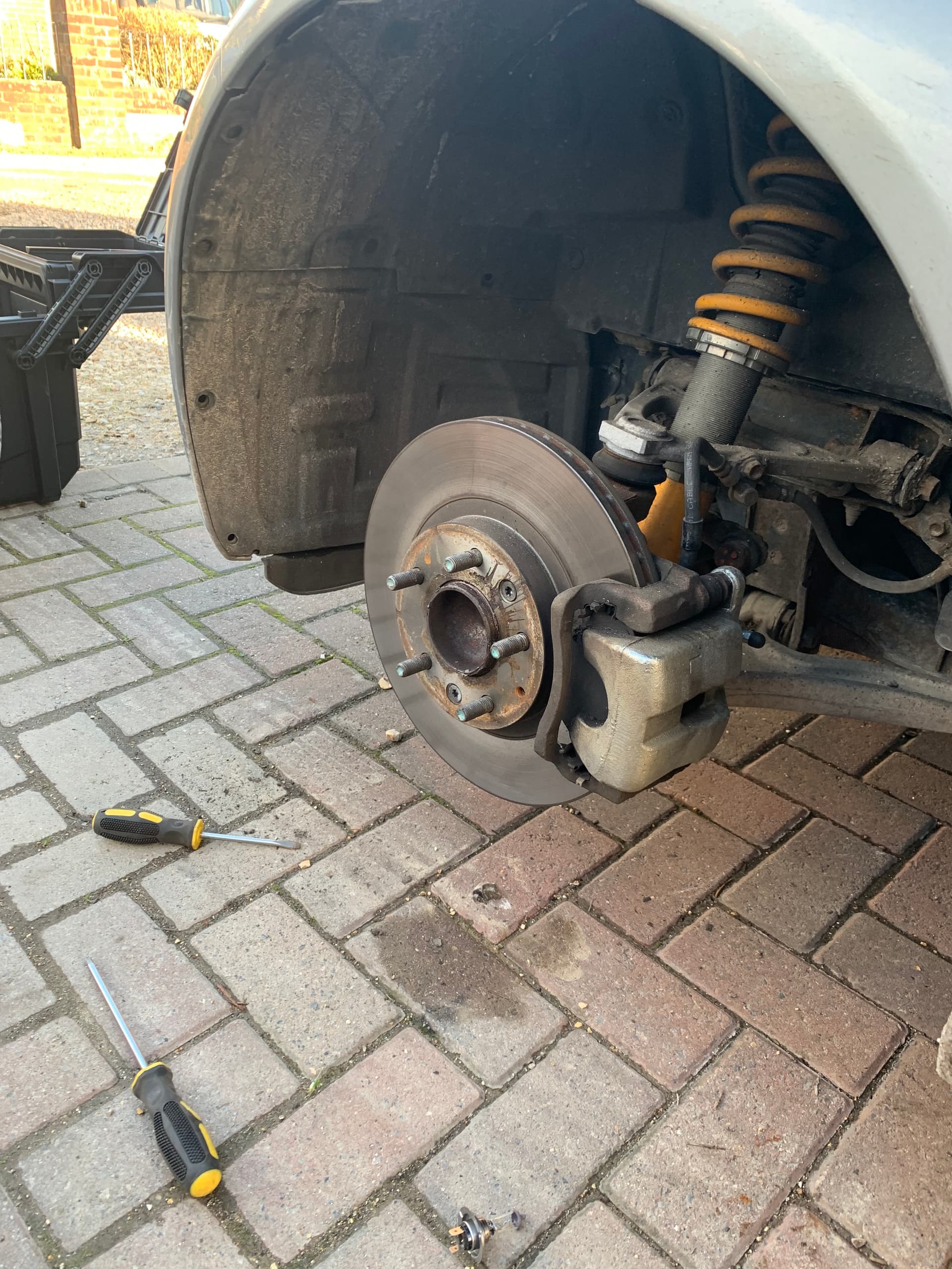

I’ve tried both the wheelarch liner loosening and the move the fusebox methods. I now favour moving the fusebox. I just remove the three 10mm bolts securing it to the body and gently lift the fusebox off the threads - you don’t need to do any more than that and you can get your hand in to remove the plug, cover and bulb. (obviously large hands may be a tight fit)
I was surprised how little movement of the fusebox was needed to give much better access and without removing a wheel or getting dirty.

I’ve never found an easier way! Infuriating. Actually there’s little need to remove a wheel, just turn it on full lock.

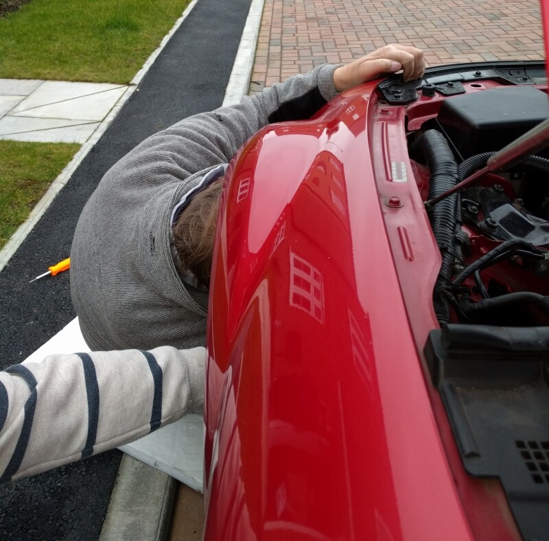

Lots of room for a head and a friend’s arm holding the liner out of the way. Just make sure you chock the car up safely before inserting head! Still working blind though!
I’m a big chap, turning wheel on either lock didn’t give me enough room.
I tried and failed from above (i’ve only suceed in changing the position lights from above),
so i went to the local car electrical repair shop and let them change it, they went from the wheel liner without removing the wheel! and suceed :grinning:
