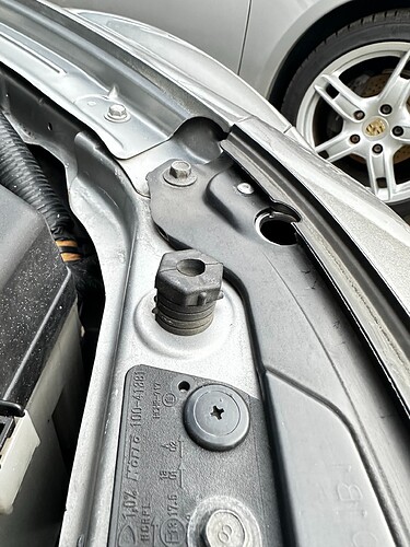

I did look at those and in my nc they have a moulded leg that fits in a hole/slot on a thin flat part of the bodywork. No screw underneath that
Mine just screwed in and out…you twist the rubber. clockwise to lower and anti clockwise to heighten from memory
What generation is yours?
Hi Robbie,
Mine is a 2011 Picture of the rubber :bonnet close bumpers " below. You’ll se the 17mm (i think) socket head on top.
ok… that’s slightly embarrassing because I didn’t realise you could separate that into two parts :sweat_smile:
