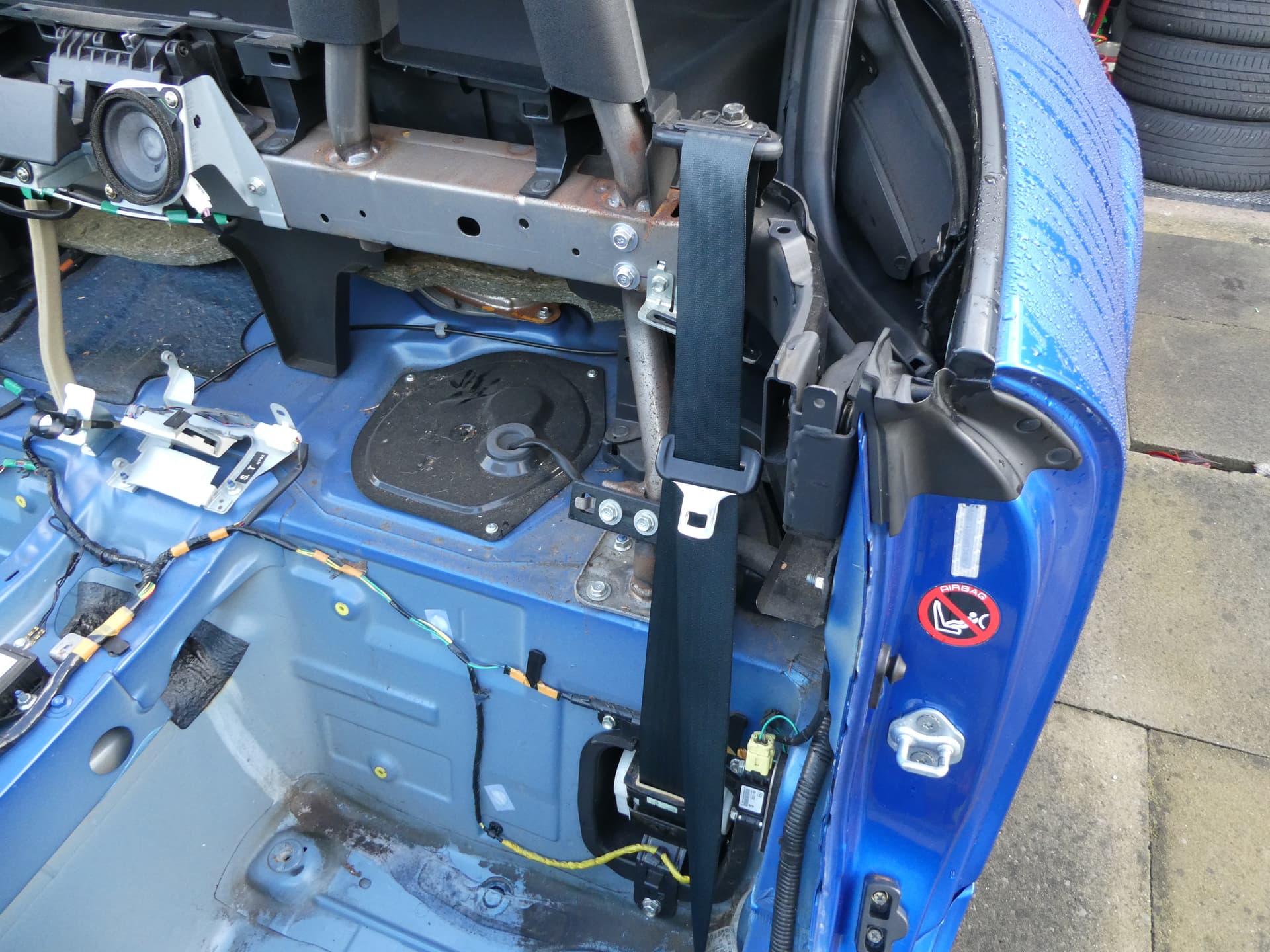

I went the whole 9 yards and pulled all of the interior out of the car.
The rockwool type soundproofing under the carpets was completely soaked and came away in chunks.
Car is now completely dry inside and shows hardly any misting up even after a good rain session.
