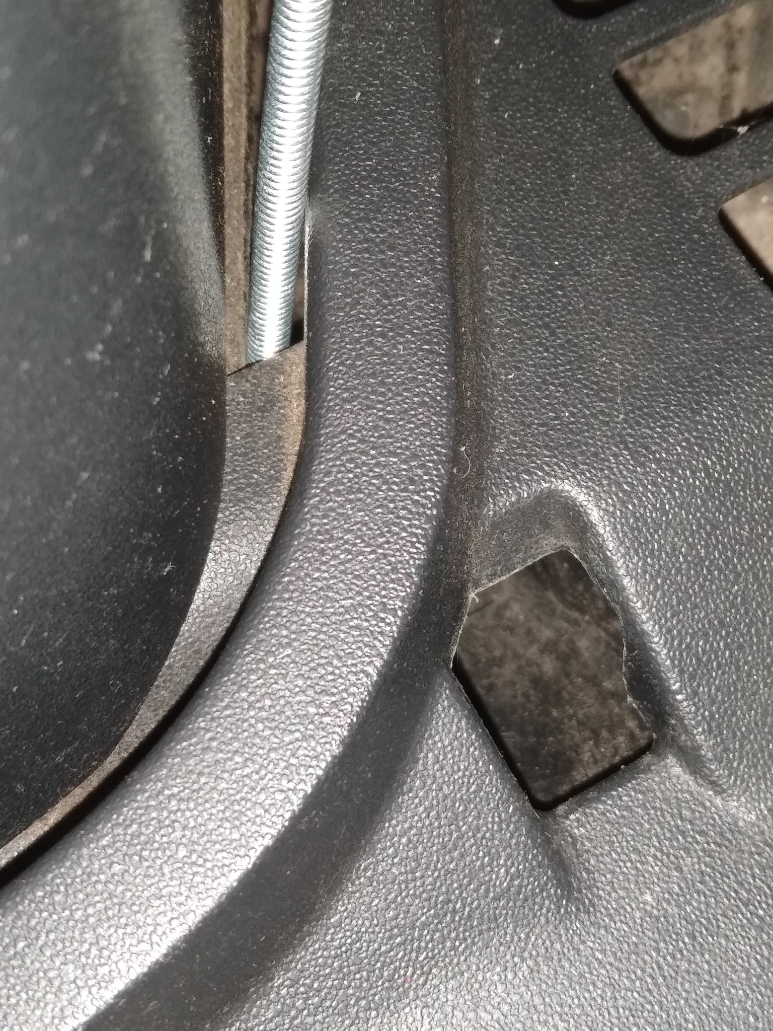

Bear with me, I’ll try and get a picture of said drain hole, hopefully it’ll give you an idea where to aim for.

As mentioned above on the picture with the blue arrow pointing the way in.
I managed to find the drain hole just there. If you ease the plastic open just there, with a torch and your head in there (not much room) you can see said hole.
My pokey thing down there in the picture below, I used what resembles a metal flexi curtain wire…
For a sure way to find the hole get a cheap endoscope. The image below was taken through the square hole using a Depstech usb endoscope on my phone. It is then easy to see the trombone brush go down the drain tube.
Whether you go in through the red square hole or the blue arrowed slot you are aiming for the hole about where the white X is marked.

I have an endoscope and with the aid of a torch just about managed to see the hole but even with the light on the end of the scope it’s still extremely hard to see…
Anyway after another few goes I managed to clear both sides. The passenger side was the least agg compared to the drivers side which was just a right pain…
