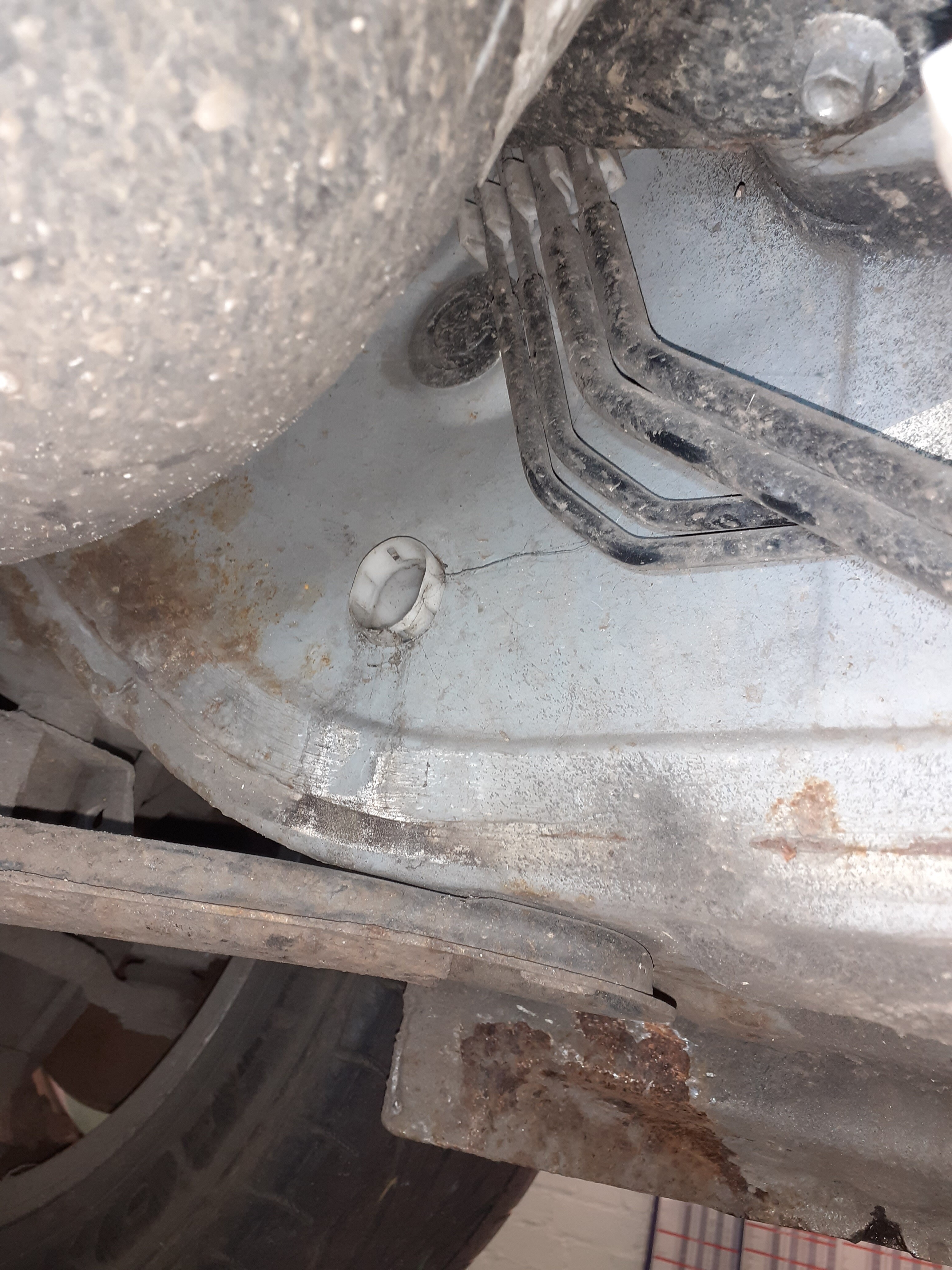

Guys I’m really struggling here I just cannot find either of the tubes to push the brush into.

top is really difficult to find bottom is a bit easier, if you can see white oval about 20mm dia inside the cill in front of the wheell!
If you clear from the bottom the one way valves will invert, causing it not to drain in future and let road noise into the cabin. That is why you go in from the top and out through the bottom.

Never push the cleaner up from the bottom you will force the one way flaps up and not allow the water to drain through or will stick open and allow road noise up into the car.
