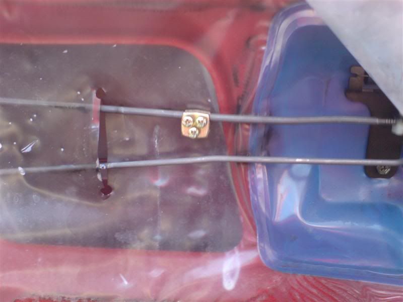

Fitting
http://i35.photobucket.com/albums/d185/Goof-UK/S%20Special/Central%20Locking/DSC00441Medium.jpg
http://i35.photobucket.com/albums/d185/Goof-UK/S%20Special/Central%20Locking/DSC00440Medium.jpg
http://i35.photobucket.com/albums/d185/Goof-UK/S%20Special/Central%20Locking/DSC00444Medium.jpg
http://i35.photobucket.com/albums/d185/Goof-UK/S%20Special/Central%20Locking/DSC00447Medium.jpg
http://i35.photobucket.com/albums/d185/Goof-UK/S%20Special/Central%20Locking/DSC00446Medium.jpg
I used some Cat5 network cable to thread the wire through the rubber tubes after they had been disconnected from car & door.
Net curtain wire would probably be the best, but I didn’t have any in my tool box!
The control box was stuck to the plastic panel between the steering column and centre console - there’s plenty of room there.
Be sure you secure the wiring in the door with cable ties to avoid interference with window mechanism.
