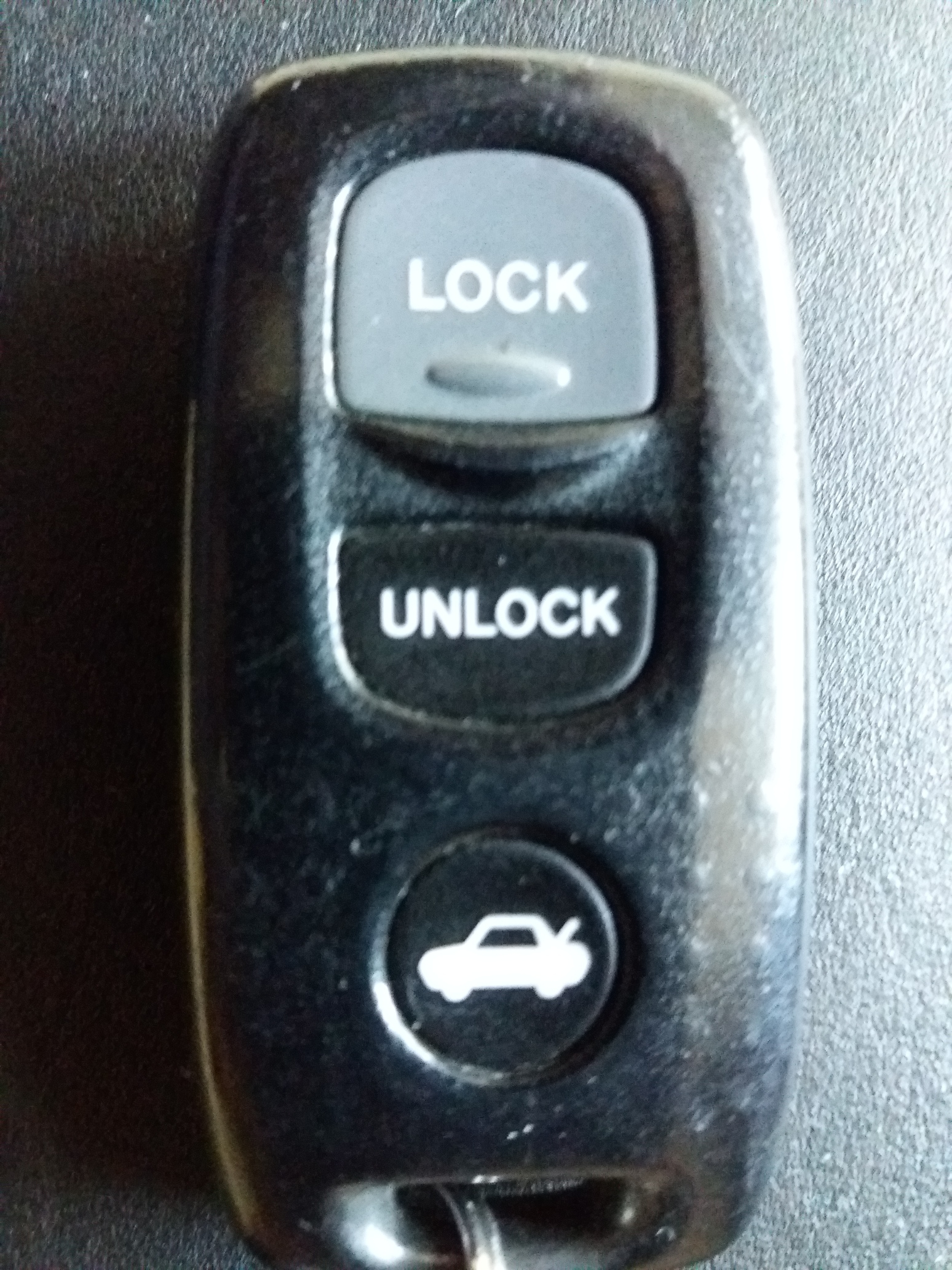

The Key I have is I reckon the original mazda key, however the markings on it are gone.
Would you be able to tell me what the 3 different buttons are , starting from the top where the ring for the keyring is please .
Yes , it does sound like a wind up, but I take it with thanks , pretty much the same as Dipstick suggested.
Ill report tomorrow.
willie
does this help?

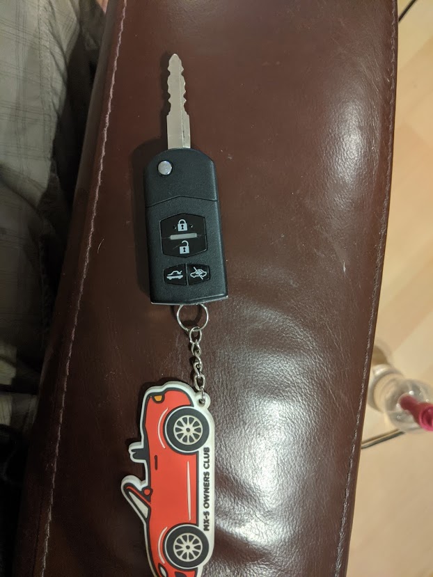

Mazda Mk3 keyfob
See video I posted yesterday
indeed it does , many thanks
w
