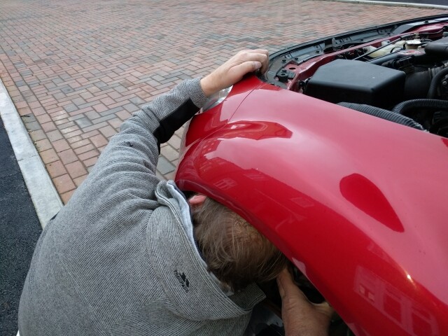

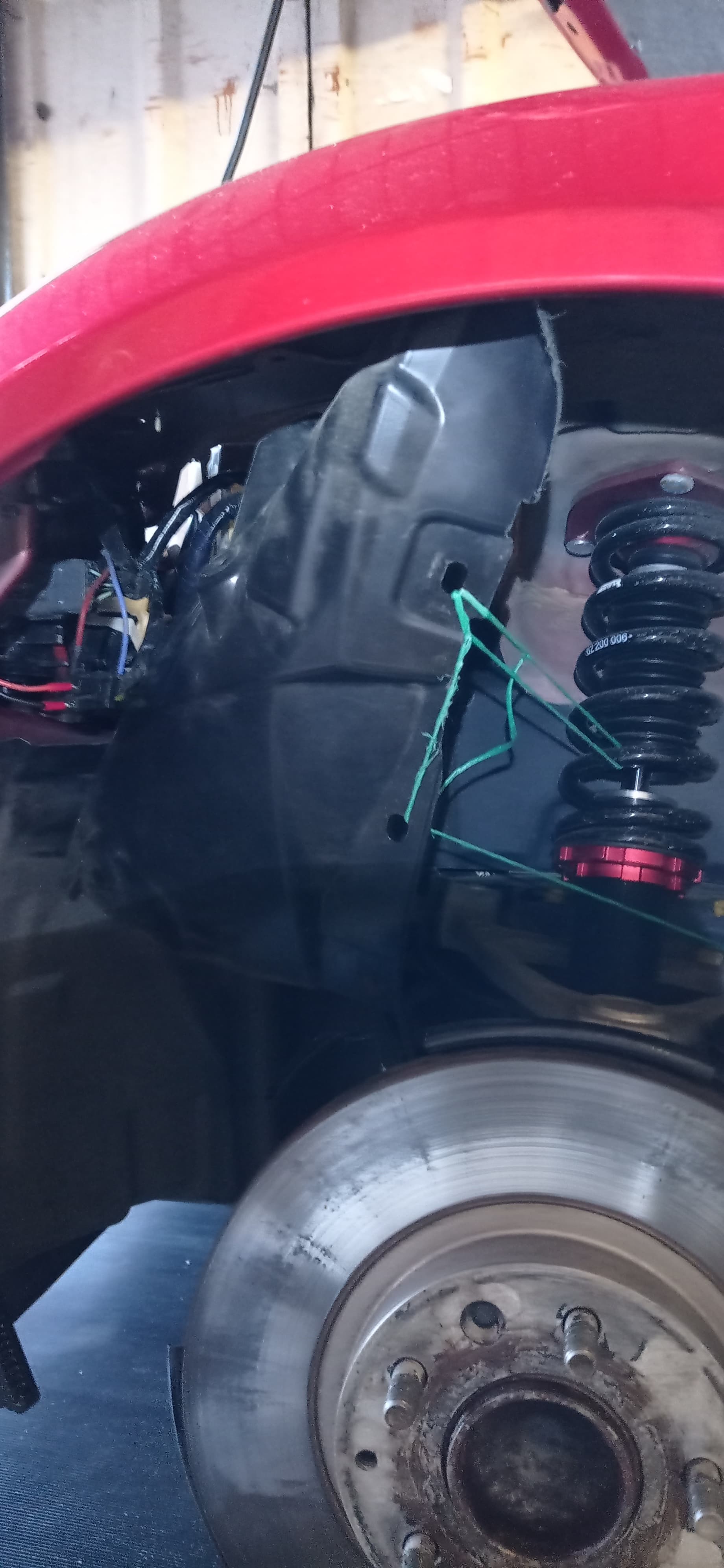

Easiest method is to go in via the wheel arch liners. I take my wheels off to gain best access, you can do it with full lock on should you not want to remove the wheels.
I did mine as above.
Just loosen and peel back the liner from the front,(i.e you don’t have to completely remove it).:+1:

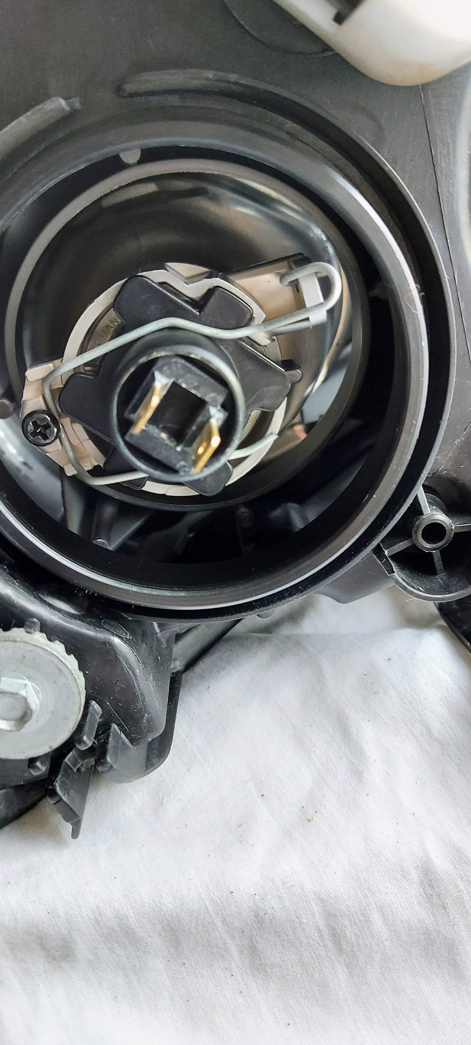

When you actually get there this pic of the retaining clip may help you to remove the bulb and the adaptor. Its not easy to see up there.

Take a note that when I changed the indicator bulbs (changing them to “switchback” indicator/DRL) the edges of the wheel arch liners are Sharp and can/will maim you. Taking a wheel off will give you more room.

Jack up, wheel off, make sure well supported, head in and hope for the best! Really fiddly getting the retaining clip back on. A spare hand holding the liner back helps.
headin

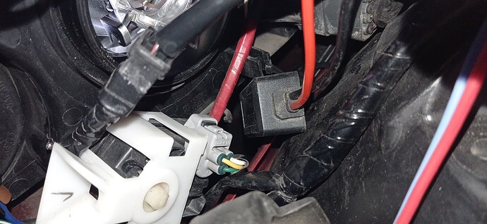

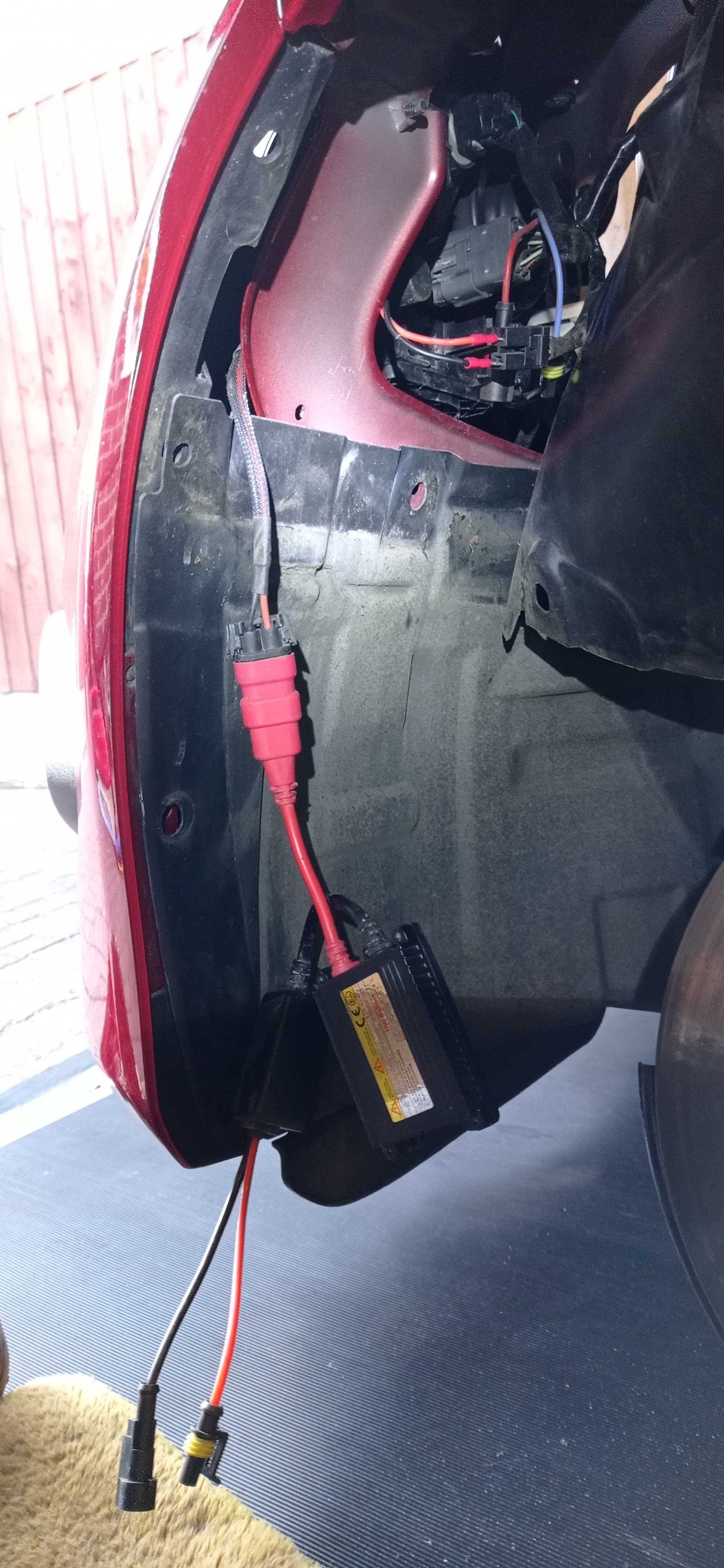

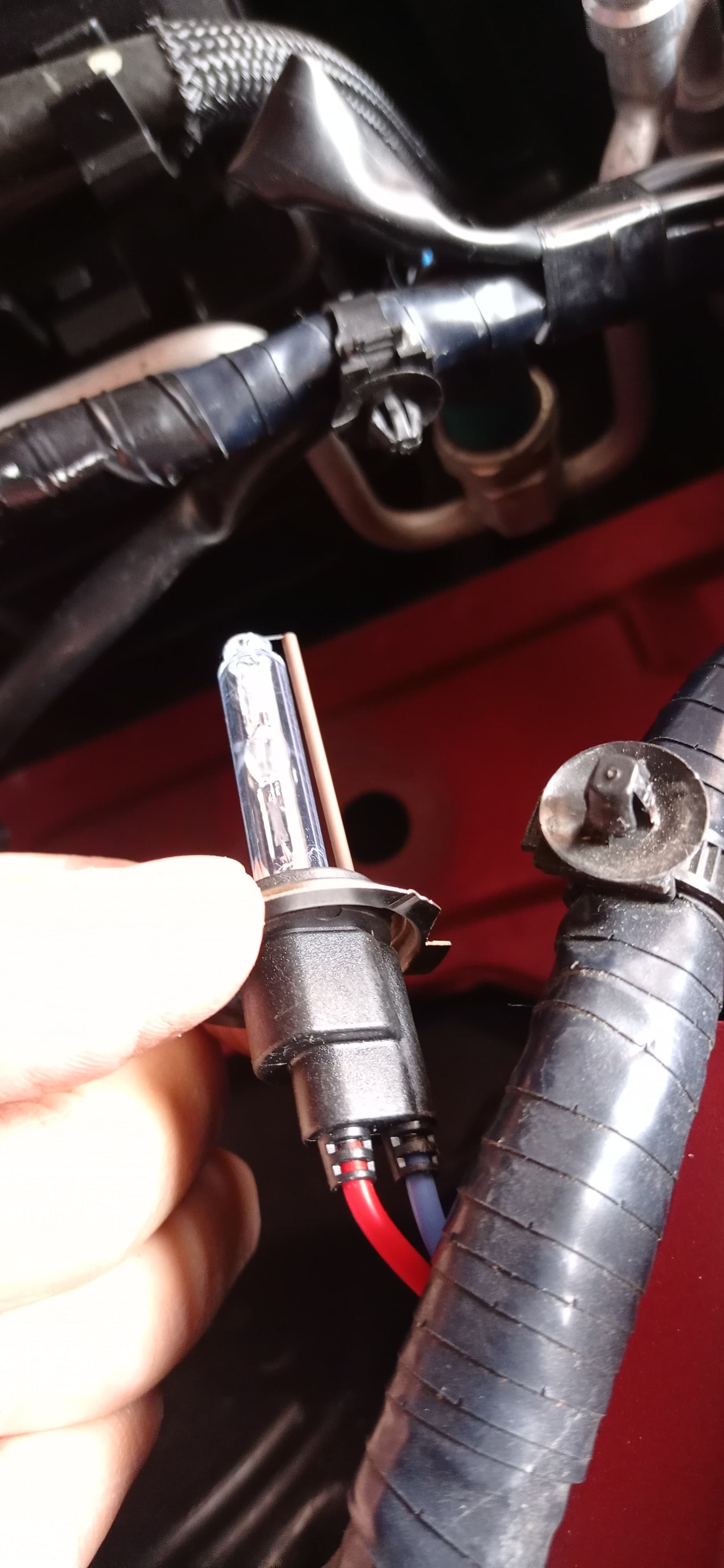

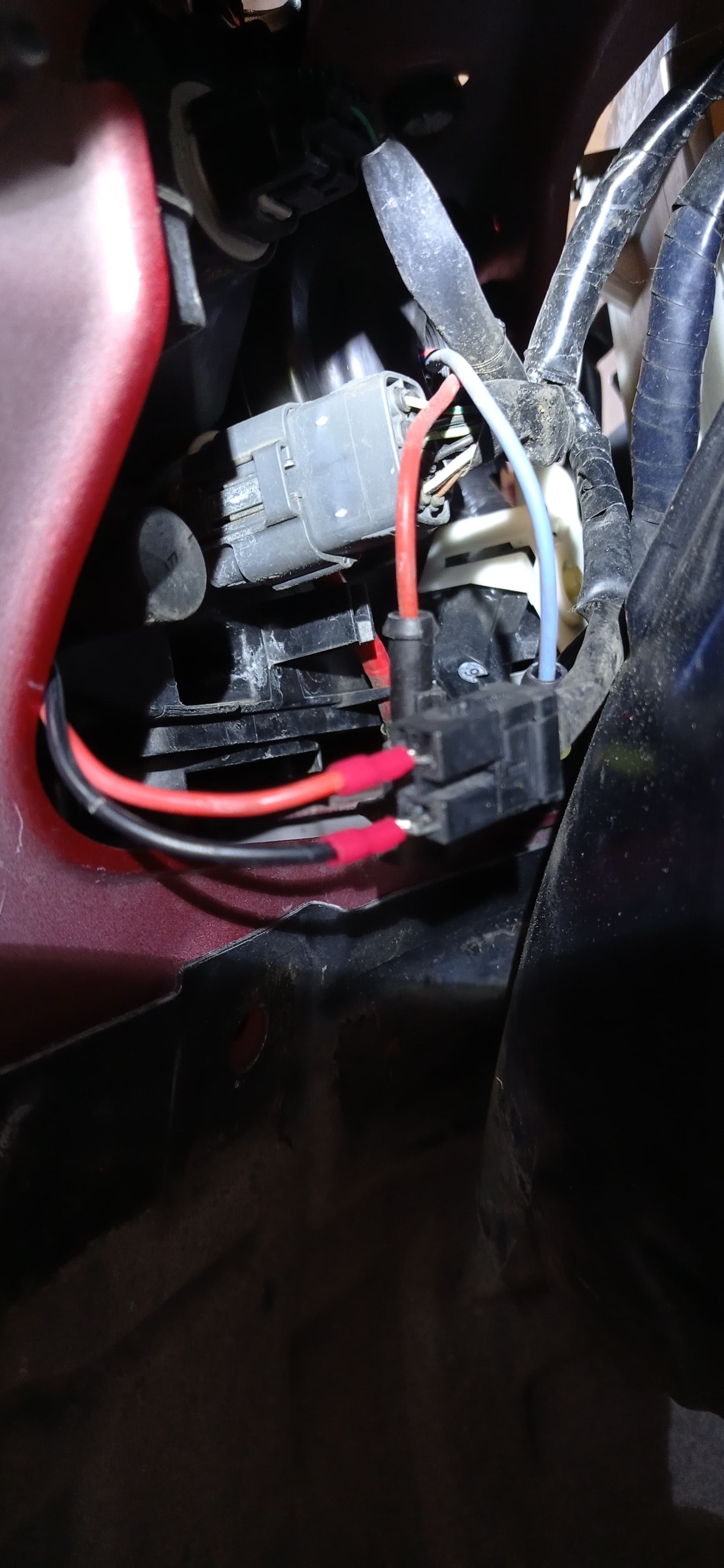

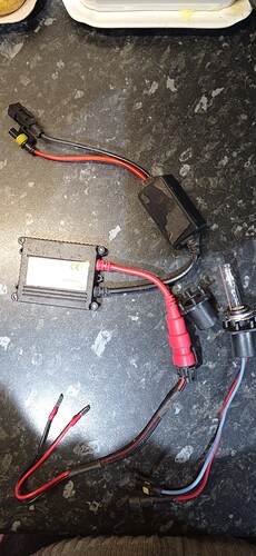

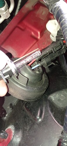

Sounded pretty straight forward,but on accessing the rear of the drivers side headlight it would appear that the car has Xenon HID bulbs fitted and red and blue wiring disappearing out of sight below. The original wiring and female end plug(the one that pushes onto the 2 prongs of the light bulb) I can’t see. Can anyone tell me if this wiring comes from out of the main loom above the headlight or from below. I want to find it and put everything back to factory spec with ordinary bulbs.

Good idea, aftermarket HID and LED bulbs are now MOT failures so something like Osram Night Breakers or similar will be a noticeable improvement over a “standard” bulb.
However bulbs burning twice as bright will last half as long - but I’ve had 3 years of use on my Citroën with Osram’s and not had a bulb failure.

I have now replaced the aftermarket HID set up completely and installed Osram Cool Blue bulbs. Very happy with these.
As some members mentioned,it’s not easy to replace bulbs on the MX.
