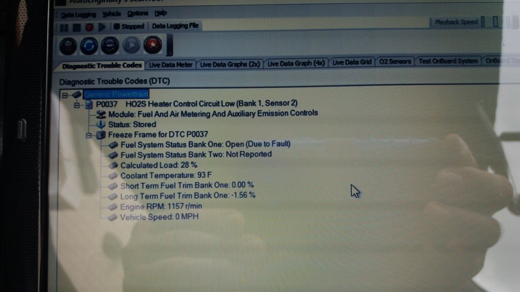

My car has thrown up a P0037 code. If I knew how to take a screen capture I would have, but for now, this pic will have to do.
I intend to replace the rear O2 sensor, but, have a few questions.
