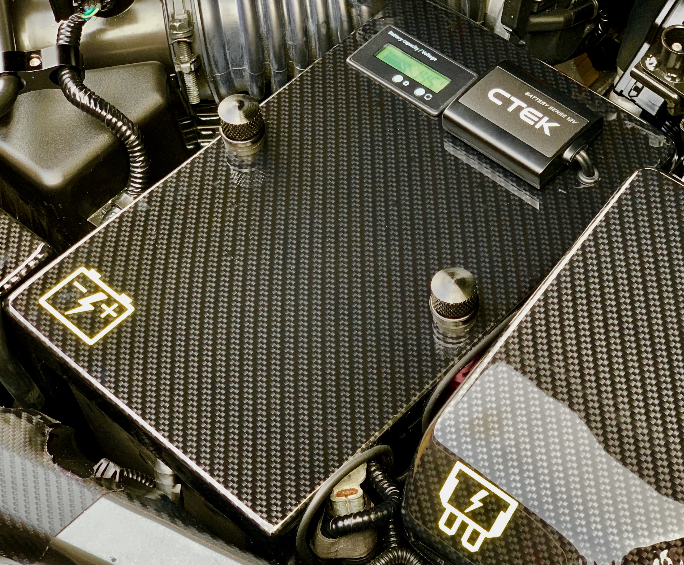

I’ve recently bought a low mileage 2020 ND 1.5 R-Sport and noticed it has the i-ELOOP system. Not something I really wanted but have to live with it. I believe the system has been around for a while now and wondered if there’s been any issues and what to look out for. During the winter months I intend to hook up to a CTEK 5.0 smart battery charger, is this charger compatible with the i-ELOOP system? Thoughts appreciated…
I have i=Eloop and had no problems/issues connecting with CTEK & it’s plugged into the car every time she’s parked in the garage 4 years plus now .
The only issue I have had is that sometimes the stop start does not function. The display indicates that it is the battery that is causing this. Disconnecting the negative battery terminal for 10 minutes has always fixed this problem.
Using a smart charger has never created any issues in the 4 years of ownership so I think you will be OK.

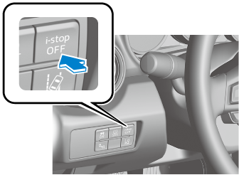

If you car has it:
  1. When stationary the engine should turn off (start-stop)
  2. There is a notable amount of “engine” (regenerative) braking
  3. There should be an button above your right knee to disable it:
    05010601-nda-001
