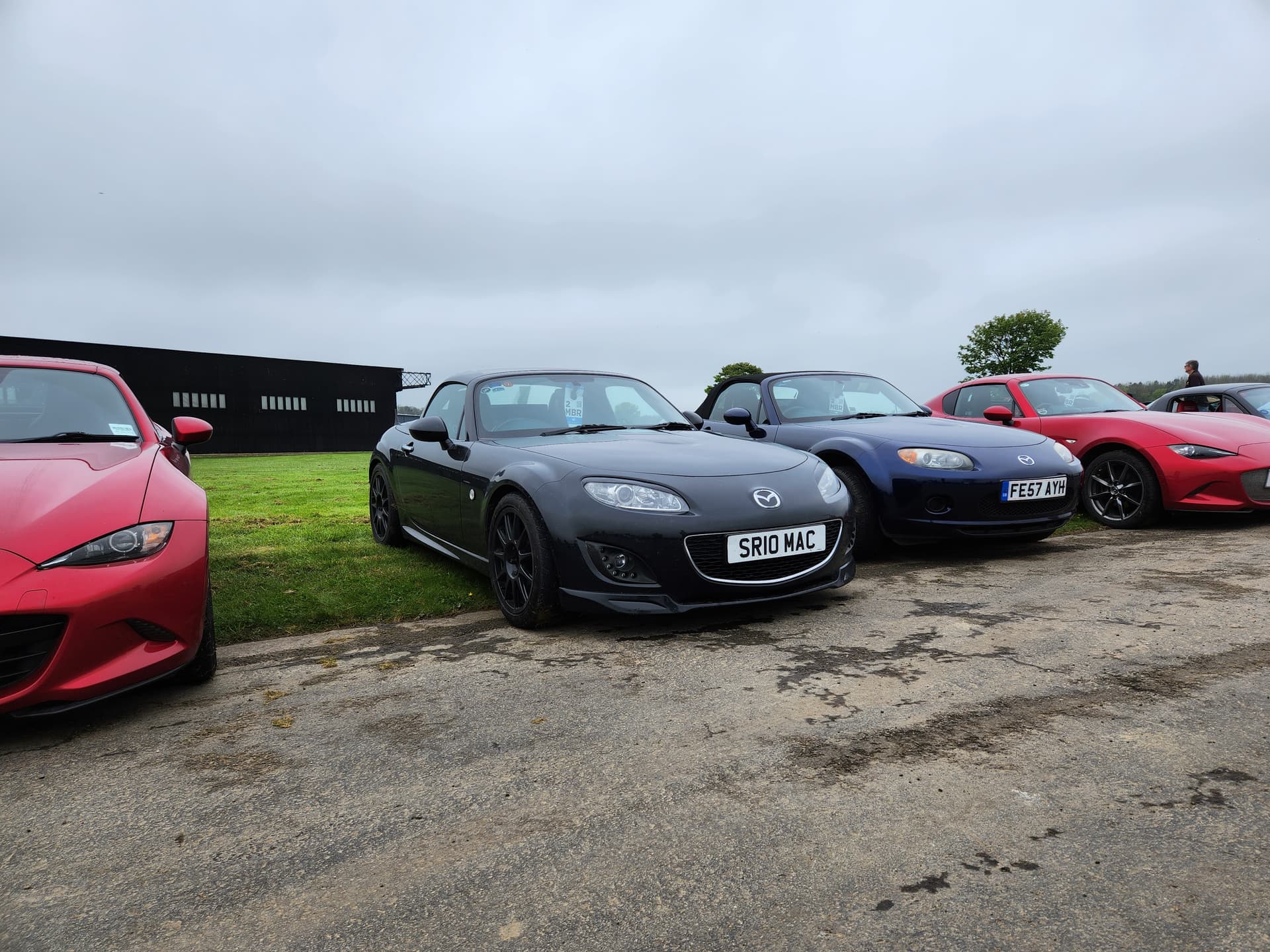

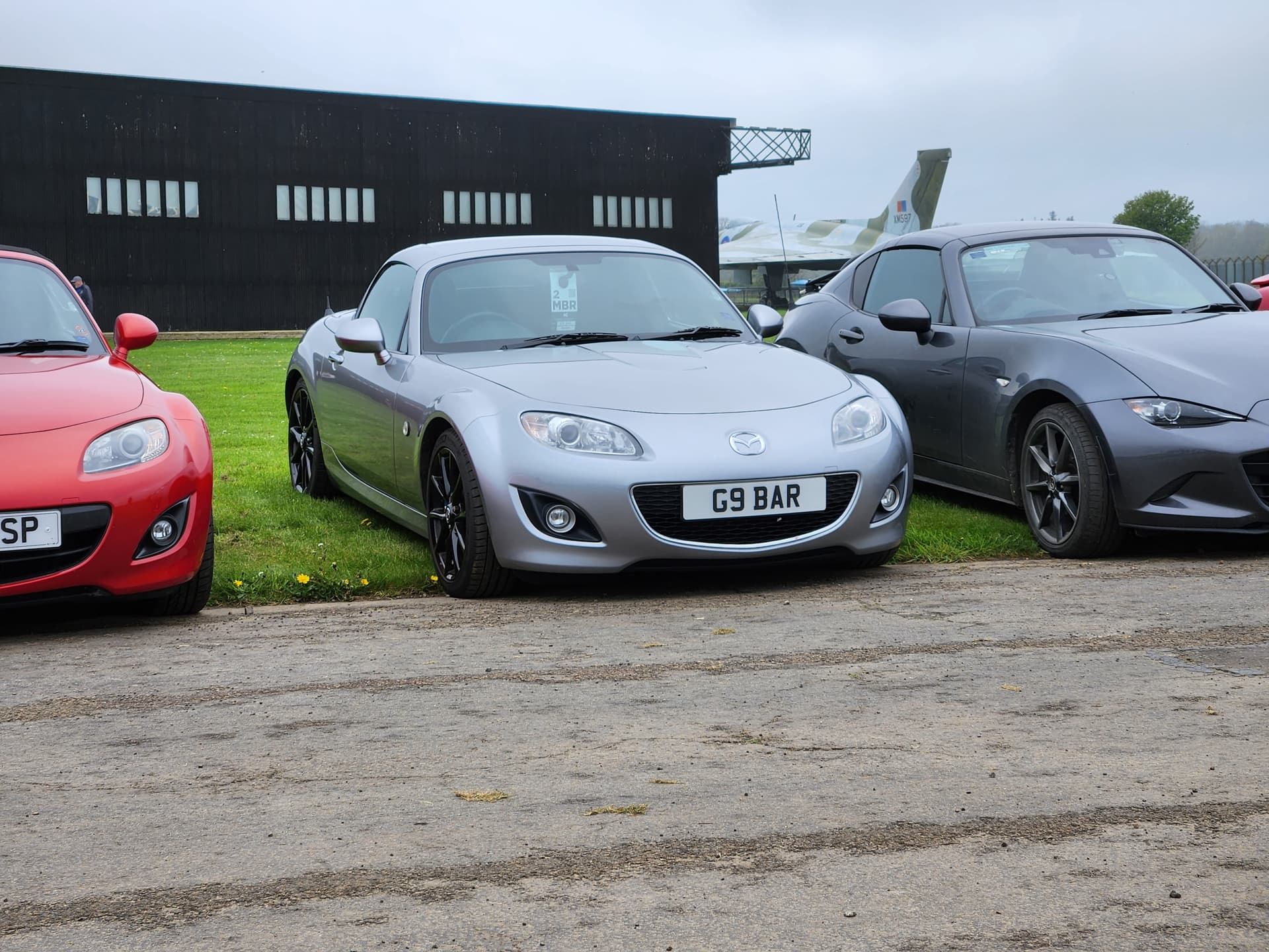

Hi guys, hope you’re all well.
I was at the spring rally last weekend and I noticed a few NCs with front splitters and wondered where i can get one as struggling to find them online.
Here’s a picture of mine and a picture of one with the splitter - it makes such a big difference when you see it in person

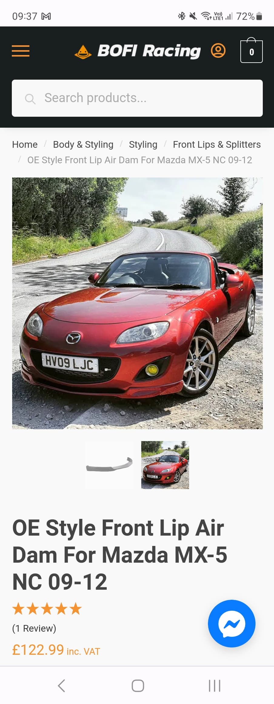

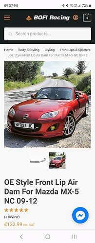

Looks very nice that!
I think I found it here :slight_smile:
https://bofiracing.co.uk/body-styling/styling/front-lips/oe-style-front-lip-air-dam-for-mazda-mx-5-nc-09-12/
Bofi Racing … it can get pretty close to the floor though depending on your ride height.
Looks good though :grin:

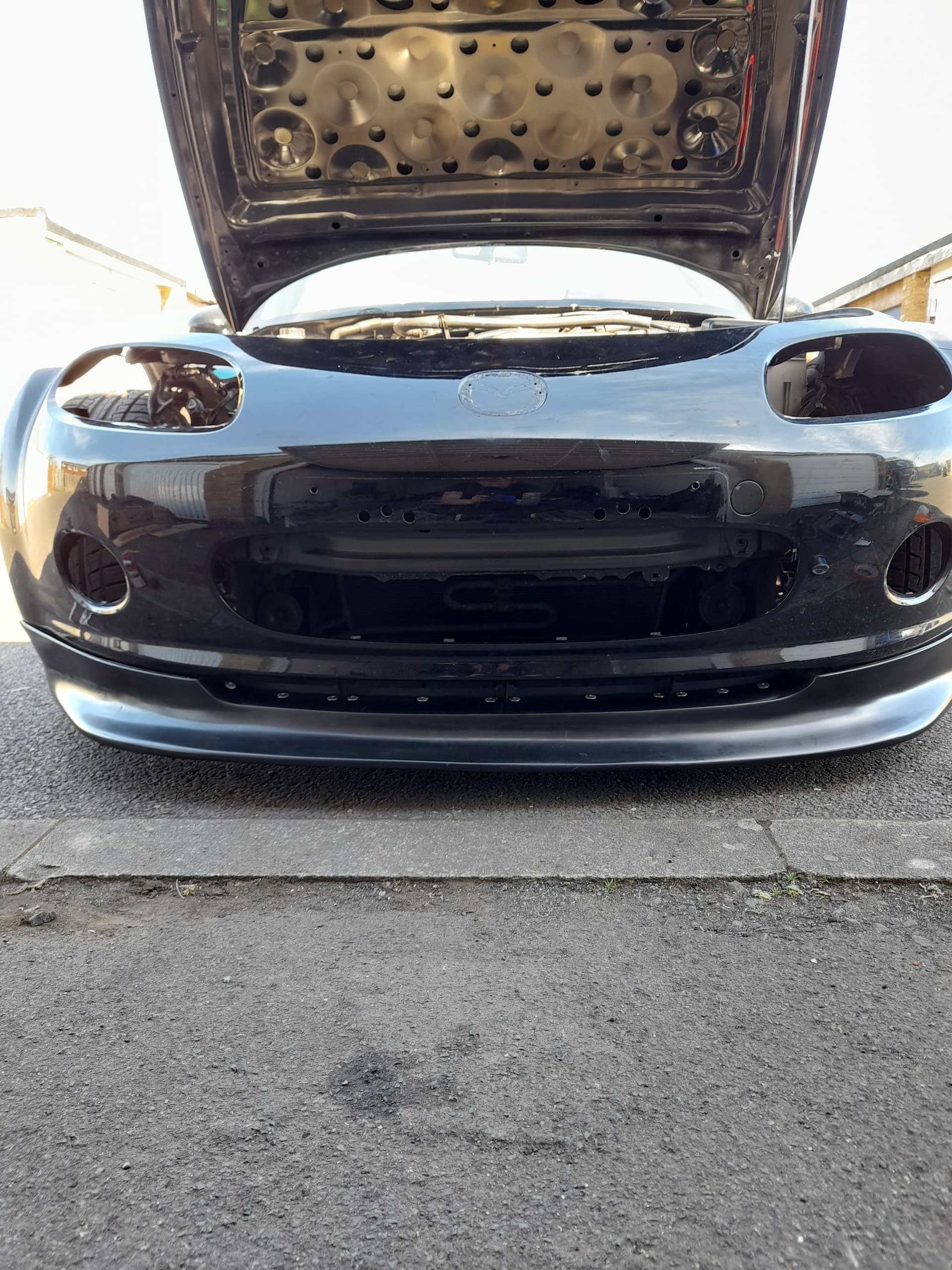

Was is easy enough to fit?
Fairly straight forward mate.
If you zoom in on picture you can see where i used alloy rivets, where it mates to inner edge of front bumper (wheel arch area) was rivited also .

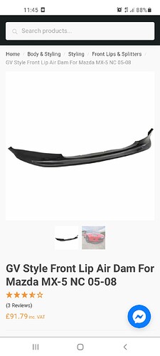

Yours is later model than mine but im sure youll pick one up
This is the one
If your going to rivet on, i placed a thin washer on the underside before pulling rivets.
Theory being to spread the pull load and stop rivet head pulling into bumper plastics.
