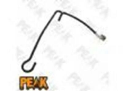

No sign of a vent tube but the little white spigot to fit it to is there. I’ve ordered one and will start the hunt for Panasonic battery on Monday.
In the meantime, I trickle charged the Yuasa battery overnight and It’s holding at 13.1v three hours after coming off charge. It has vent holes, so I’ve ordered a couple of vent tubes off ebay and will attempt to cobble something together with them as a temporary solution. Can’t be without my mx-5 driving fix for too long!

There are many good batteries available that will fit a NB. I go for the largest Ahr rating and cranking current spec. that will fit in the boot space . I currently use a BOSCH vented ,lead acid battery obtained from Tayna and have had excellent service. It is important to fit the small diameter vent pipes (illustrated in this topic earlier) However I always fit a plastic tray underneath the battery base, should there be any liquid escape. Usually a cut down 5 litre oil container makes a suitable item although I understand that MX5’s originally had a tray to fit the Panasonic type. If you use your car throughout the year then it is a good idea to use a " intellegent" trickle charger on a regular basis.
