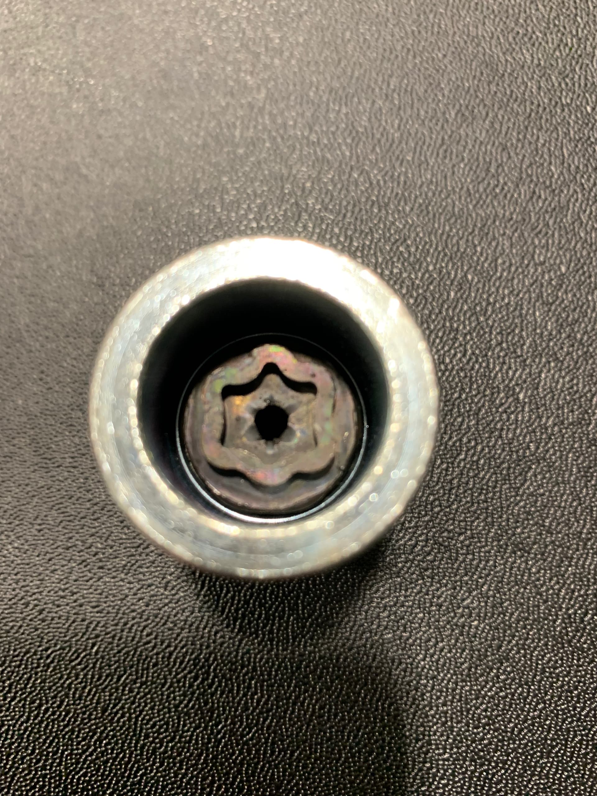

Identify McGard Locking Wheelnut
The previous owner of my Mk1 lost the key, so before I try brute force or Mazda dealer, does anyone have a list of codes \ images?
All the previously posted McGard links are now 404, and their new replacement order page requires a code. I’ve emailed them a picture also.

That is definitely McGard pattern.
I know as just sold a key and three nuts on ebay.
Plenty of others on there cheap.
Can you get a sharper photo at all?
Does it look like either of those?
Certainly, will try to take a better picture this evening. Thanks!
(Yes, that does look like the picture of the first one - will compare against the real thing this evening. Thanks again @Roadster_Robbie )
I’ve added a picture with another option
Wow, that is confusing; the inner shape very similar but the outer shape around the two wings quite different. Here are the ones I sold.
I’d say that most listed and indeed mine appear more like the first of yours Robbie.
Very confusing if McGard make two similar patterns that are not interchangeable.
New picture… thankyou all!
Looks like a 912L, I’ll get a photo of the key tomorrow for reference.

You can email McGaurd your picture and they will let you kow the correct one and sell you one…
That’s what I did when I lost mine.
I’m not that confident in my assessment from the photo to be honest. In the metal, when taking them off on a daily basis I was usually spot on. Each of the 5 common Mazda ones had a certain feature that I’d recognise. 910 is quite symmetrical with a point on top, 911 is symmetrical and sort of tapered, 912 is tapered but with a hump on top, 913 is triangle shaped and 166 is symmetrical with a flat top.
The first photo I posted is a 910 and the second a 166.
I’m beginning to wonder if ian_c’s locker is not a Mazda supplied one or one of the later ones that wasn’t as common.
If I view ian_c’s second photo with the rust patch at the bottom, it looks like a 912.
912, not so sure now…

Just to bring this to a close. McGard replacement key arrived 10mins ago, and fits perfectly.
@Roadster_Robbie The magic number was 907.
Thanks all for your input!
