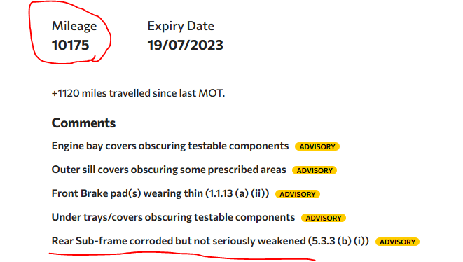

An ND has appeared fairly near me. I did the ‘check MOT history’ and this gem is present
So an advisory for rear subframe corrosion on a 10K miles car. Disgusting really.
Disgusting yes, for what appears to be a newish car but it you never know, it may have lived on the coast without any underseal protection.
It could live in the sea- but 10K miles with a rust advisory is pretty appalling, whatever the car is lol
Mind you, if that is the case, think too of all the cars sitting at the ports, awaiting an ‘update’, soaking up that sea air!!
One man’s (Inspector) slight surface rust is another man’s Corrosion. Some seem to like to include Inspection covers and other bits, presumably to cover themselves.

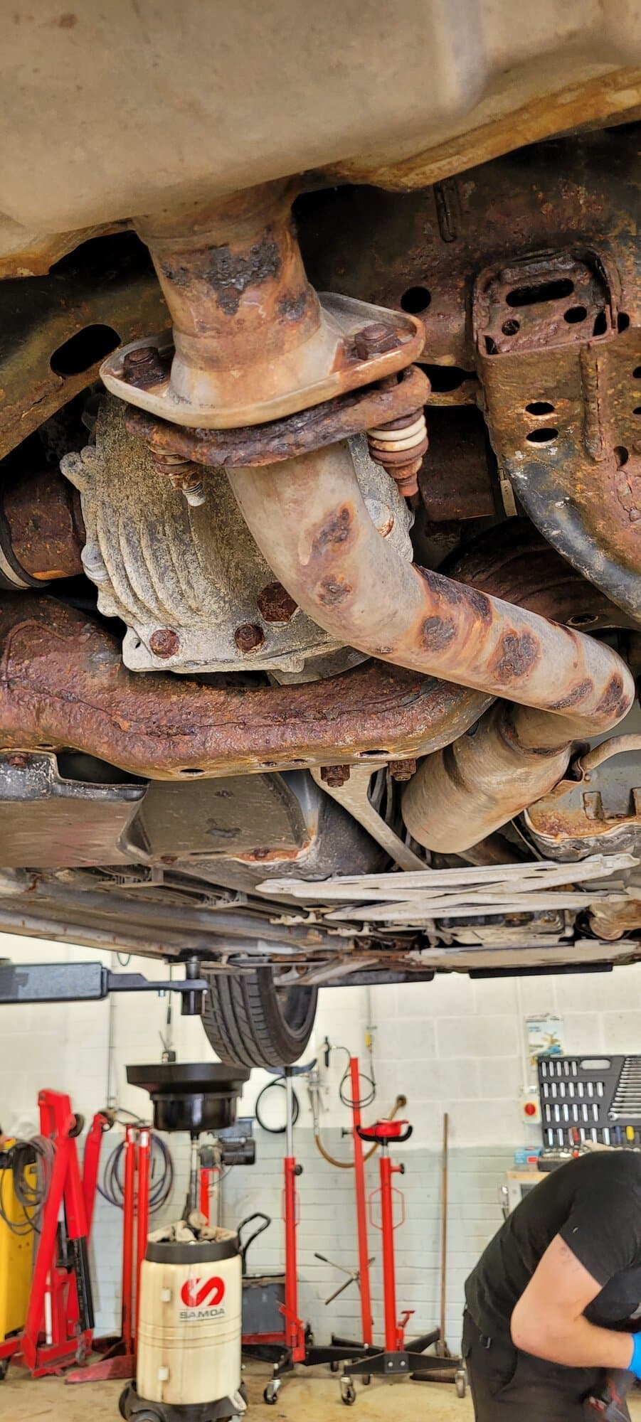

How about this for a second man’s inspection? Slight surface rust? lol
This apparently is a low mileage ND. Shown on here a while back
Shocking
Looks much like an older NC I went to look at with
a friend. Clean MOT, no mention of rust in the ad but looked just like that on inspection. The owner, only had it less than 12 months, had no idea it was that bad until they actually got underneath
Checking on the old mot’s there was mention ofrust on the subframes but still sound, unlike the sills and inner wheelarches and most of the underbody. That one looks like a seaside home or stored on long damp grass for a while.
