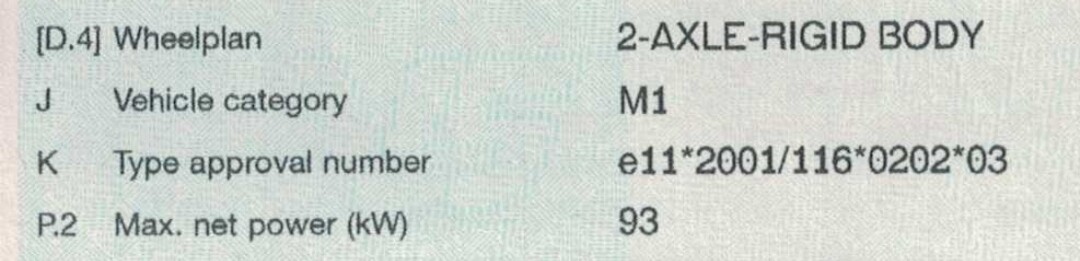

Don’t know if it’s any use but the type approval details are also on the V5
If you read the detail of the NZ requirements for Occupant Protection (not Pedestrian Protection)
https://www.nzta.govt.nz/resources/frontal-impact-compliance/frontal-impact-compliance-notice-20030625/
you will find a list of vehicle makes and models which comply. The only query on Mazda is the Bongo which has a derogation.
Amazing - I’ve got a copy of the V5 with me too!
