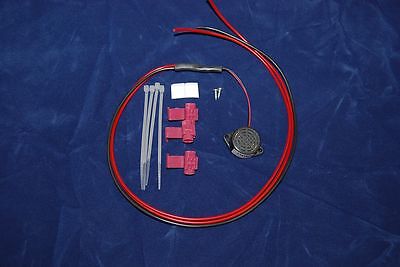

I bought two eBay buzzers and wired into my 2.5.
Could be a solution, found this on another forum. Cheap as chips but so far no idea how to fit.
On the MR2 owners forum, a very similar thread came up. The MR2 Mk3 indicator “tick” is very quiet and one of the people on there fitted a buzzer something like that. Apparently it worked very well. The way it was wired up, it beeps in time with the normal tick sound and isn’t annoying (they said).
Another suggestion was just to wire another relay in place that doesn’t actually power anything. So, all it does is open and close making a tick sound.
