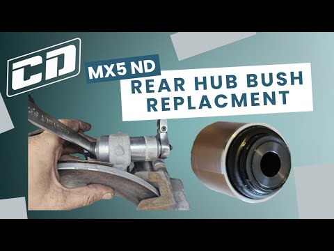

Point them in the direction of these videos, to 1. check for play and 2. a walkthrough of replacement:
Suggested replacement bearings:
