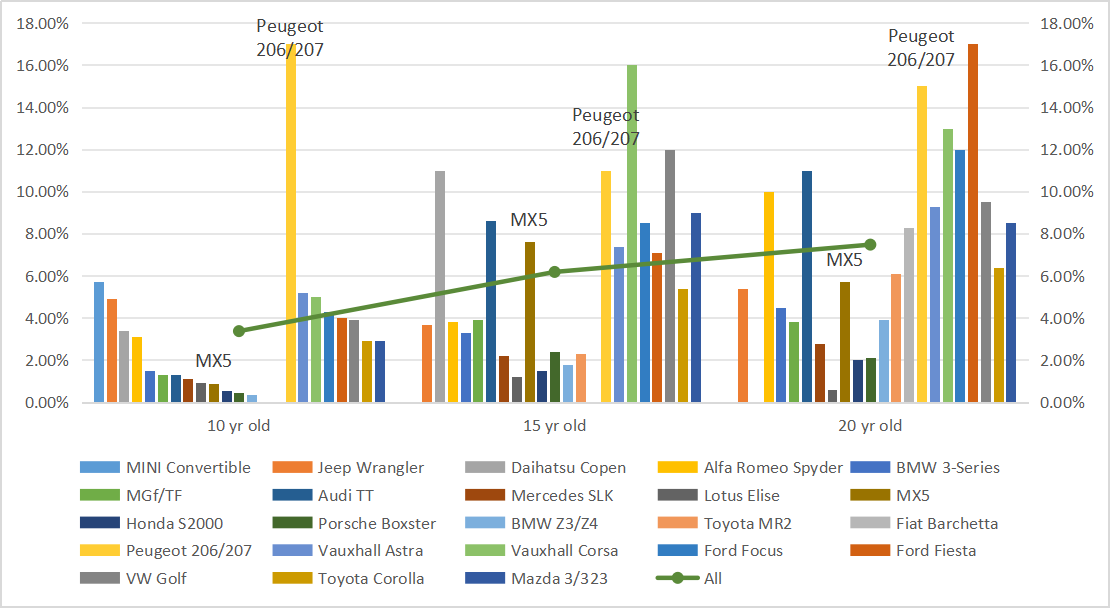

Analysis of 2019 MOTs for % fails for “Body, chassis, structure” (ie, this is directional only)
Note, there will be survivor bias with older cars; when was the last time you saw a rotted Mk1 Fiesta or Cortina? When you look at some older cars, some have surprising low fail rates for this area, but that’s likely because all the rough ones have been killed off.
Data from the MOT files. The MX5 looks ok, except for those 2004 models, which when you dig into it, seems to be down to mostly chassis rot, ie the front chassis legs, which is the result of Mazda trying to extend the life of the NA substructure by improving front crash performance. I think Citroen took a similar approach, with the same effect.
