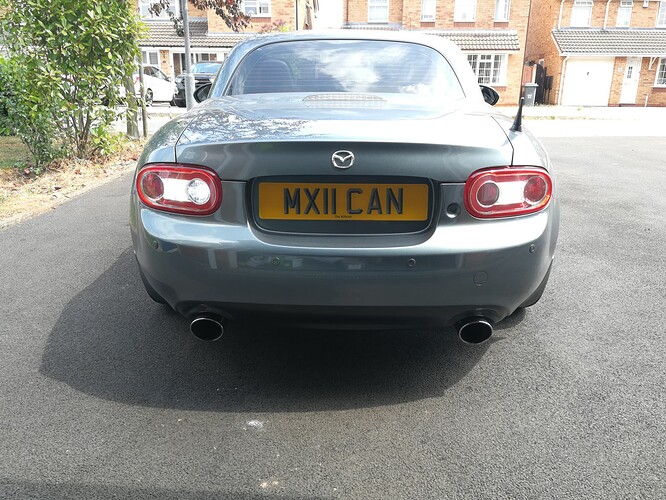

Is it possible to buy rear light clusters that have a reverse light on both sides?
my car is an NC2 2013
currently i only have a reverse light on one side and its not very good.
i need it to be better
is there anyway to make it better without taking to take the clusters apart?
ie
stronger bulb or after market clusters?
Buy a cluster for a LHD car. You can fit an auxilliary back-up light, rally style.

Just buy some switchback LED’s from Ebay and fit them into the indicator slots and connect them to the reversing light circuit. :grinning:
They also work as indicators.
