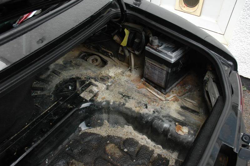

The other advantage is that the Panasonic can be mounted securely in the boot. Always a bit of a worry with bodged mountings and all that G-force in the boot. Our Eunos has the battle scars on the wing to prove it.

It may or may not happen but how are you going to vent any acid gases from the lead acid battery that may be expressed if it does not have little nipples on the battery to get rid of the acidic gasses to outside the boot like the panasonic battery has.
Some cars have had problems with the boot floor being attacked with these gases.

My Eunos had a Bosch battery when I got it, which had been venting in the boot, causing the problems already mentioned, although fortunately not as bad as the picture above. It also wasn’t secured properly, which is probably why there is a small dent in the wing, from the inside out.
