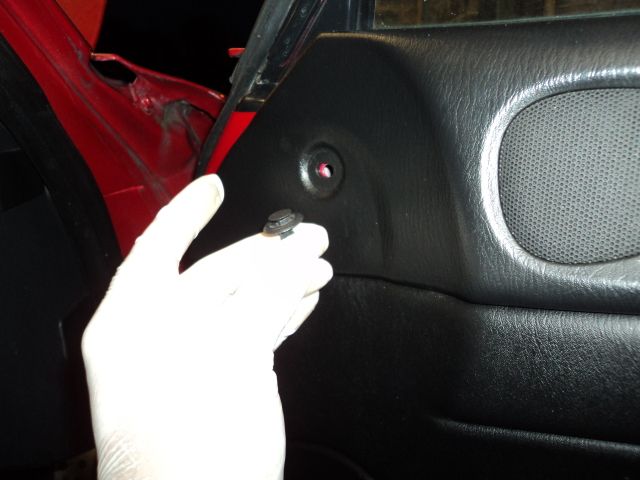

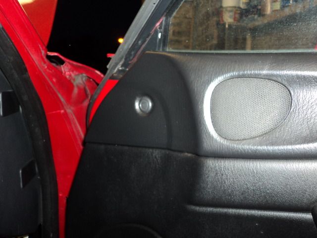

Left the centre out first, which will come out 1/4 of inch ,then pull the rest out.
Same the the outside door edge lugs.

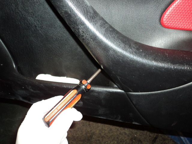

Next unscrew the screw that holds the door cup.

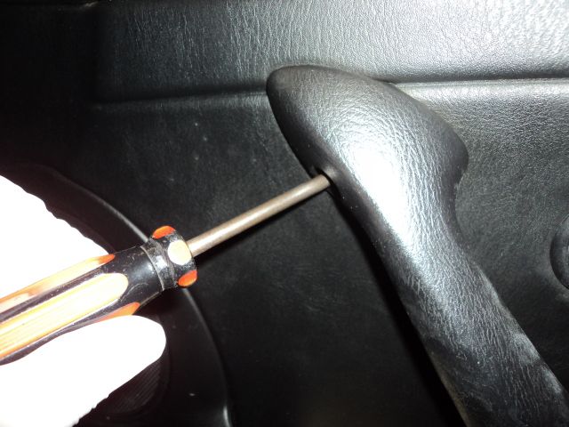

Now the two screws that hold the door card handle to the inner door skin, phillip head screws.

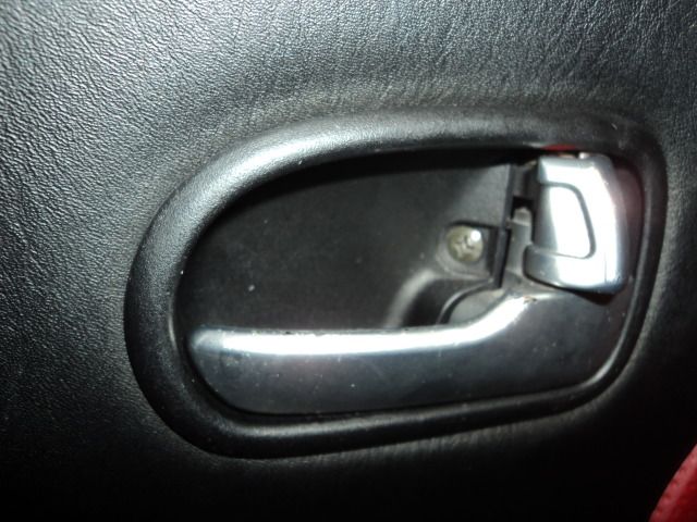

Mk 2 door handle as two screws ,one the same as the 2.5 at the top and one in the handle underneath the small carpet trim, other wise everything is the same on both models.
