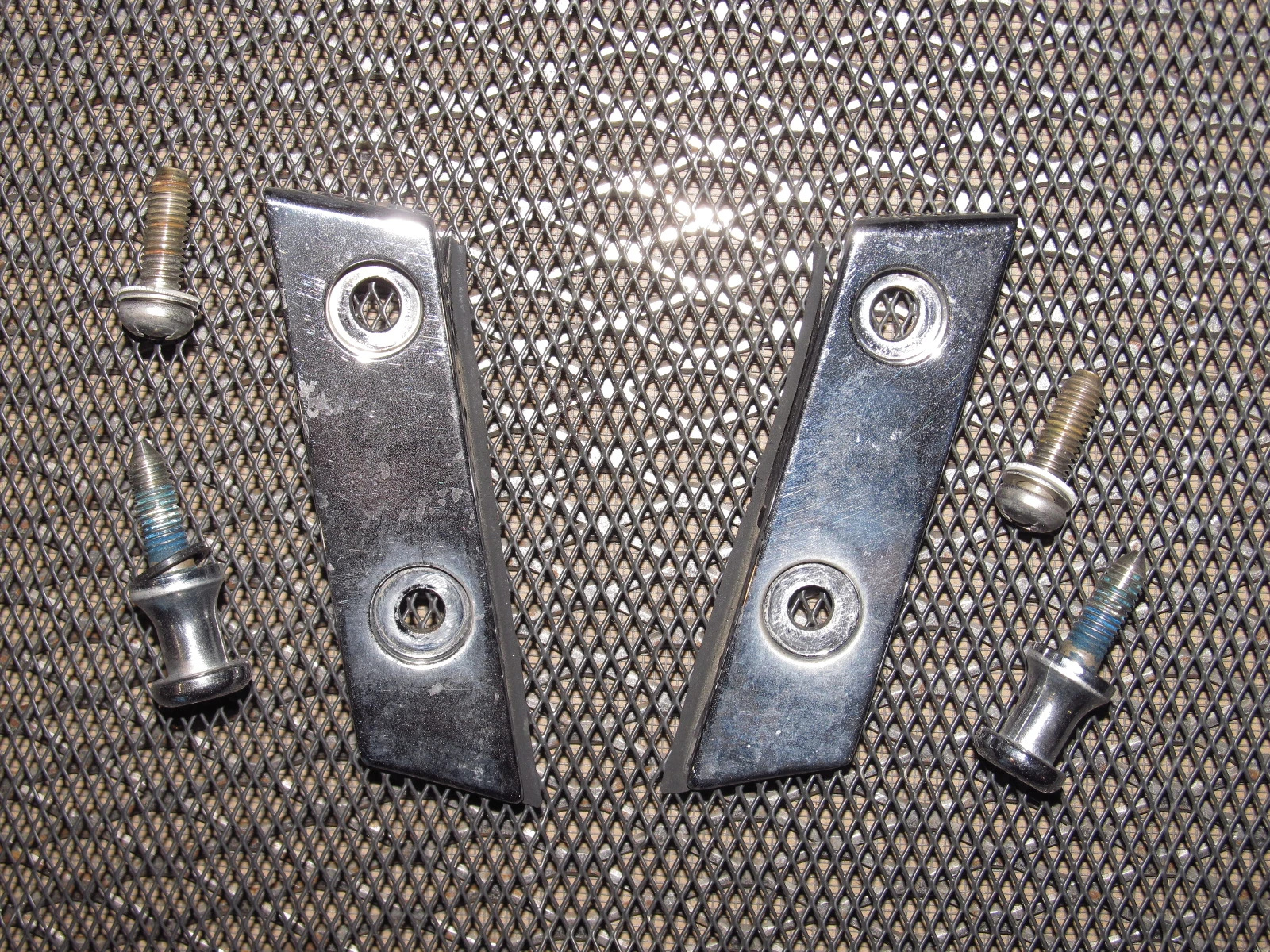

The bollt has two parts. The head and a threaded stud.
Its either spinning on the captive nut on the car, or on the stud.

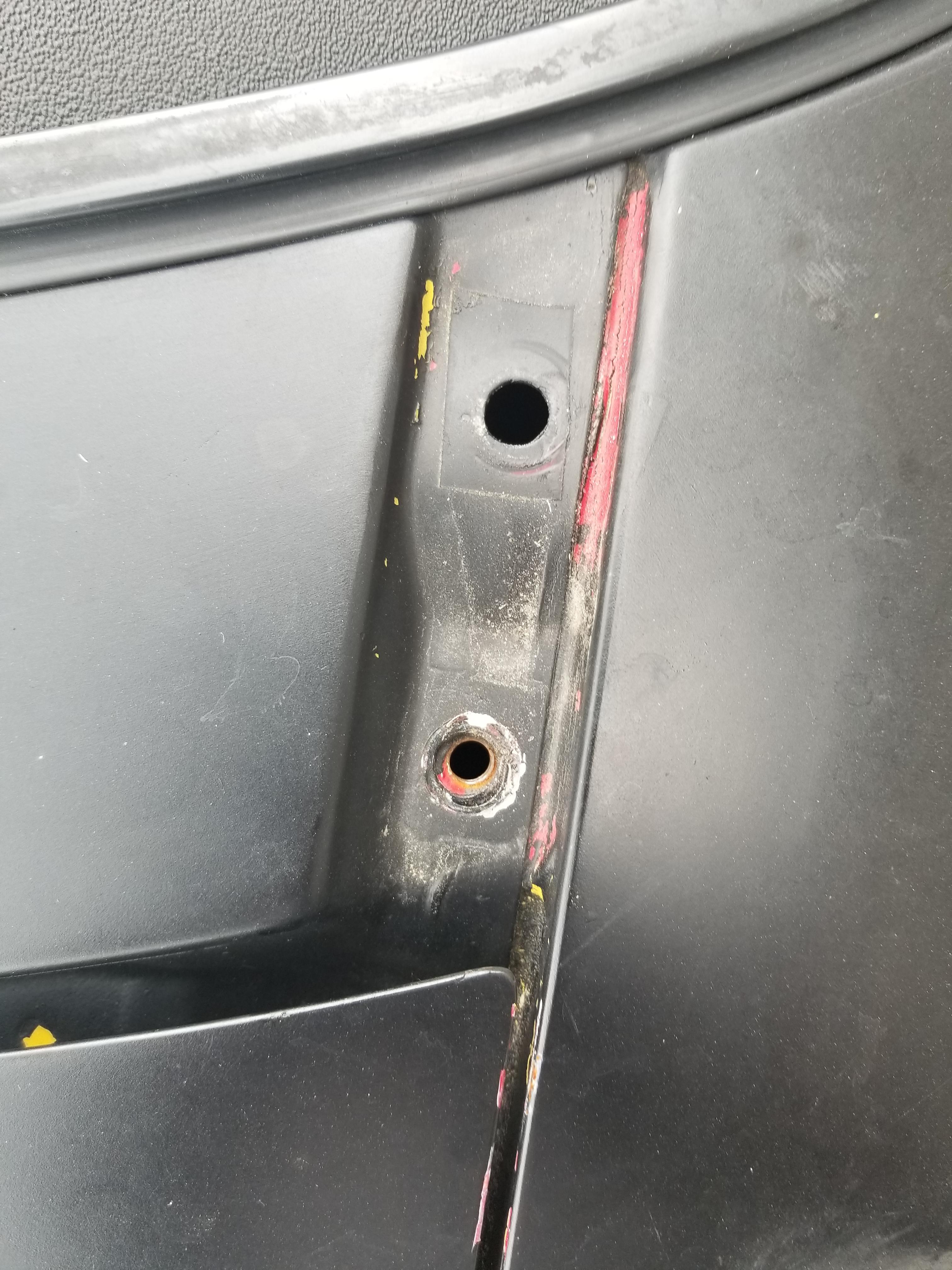

This is what is underneath

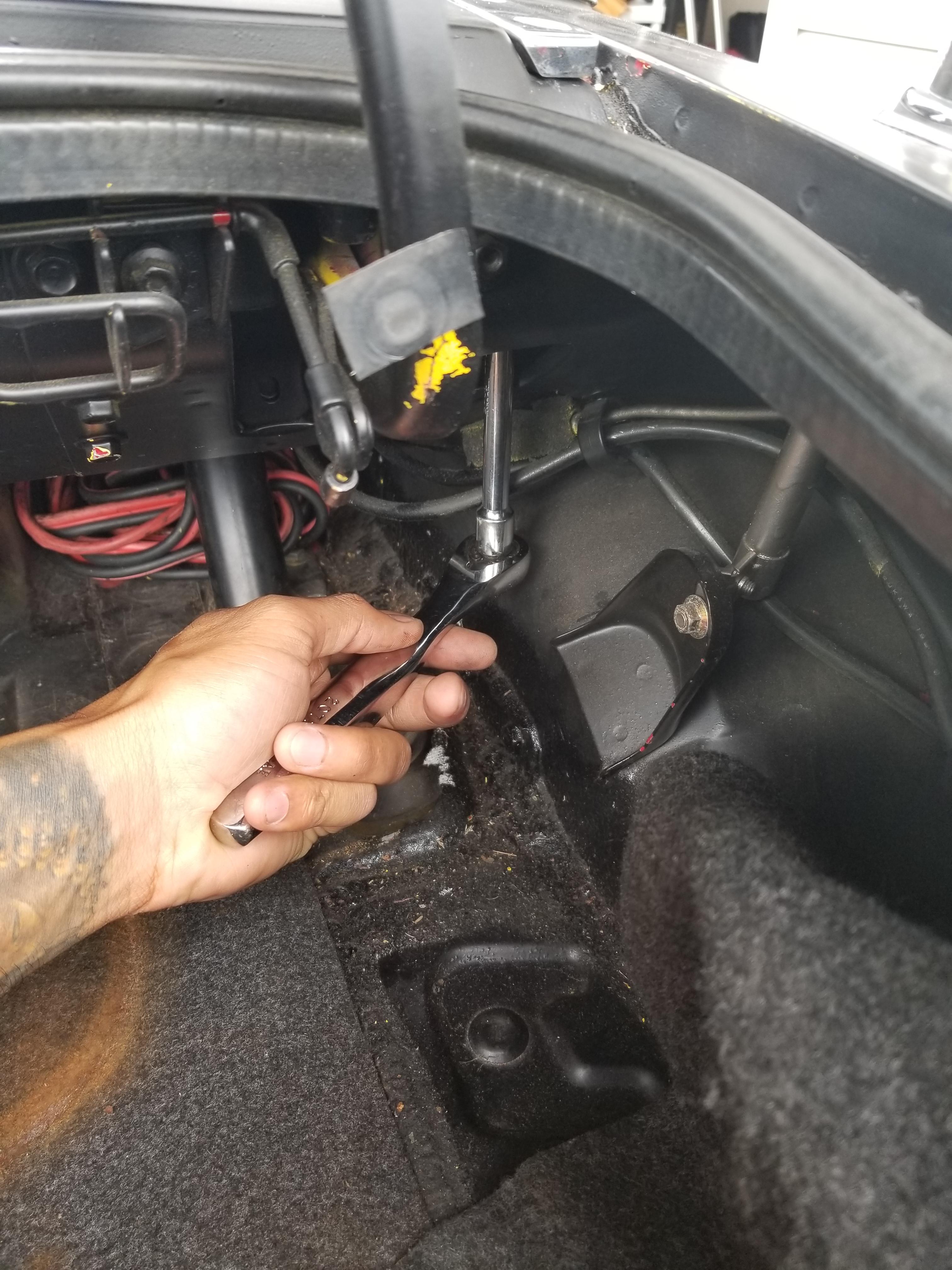

You might be able to reach up blind in the boot and figure out what is going on
Thank you.
I think this may be a failed designed on the mazda. Not having a removable nut, instead the nut is welded to the body?
I’ll give this a shot over the weekend.
No, its a failed effort by someone who tried to previous remove the bolts. Why are you fitting new ones?
Another possibility that I have seen oin other MX5s is that rear end damage and repair has resultedin bodgery. I have seen a Mazda dealer replace the rear wings on a car, and tried to form a tread using filler.
