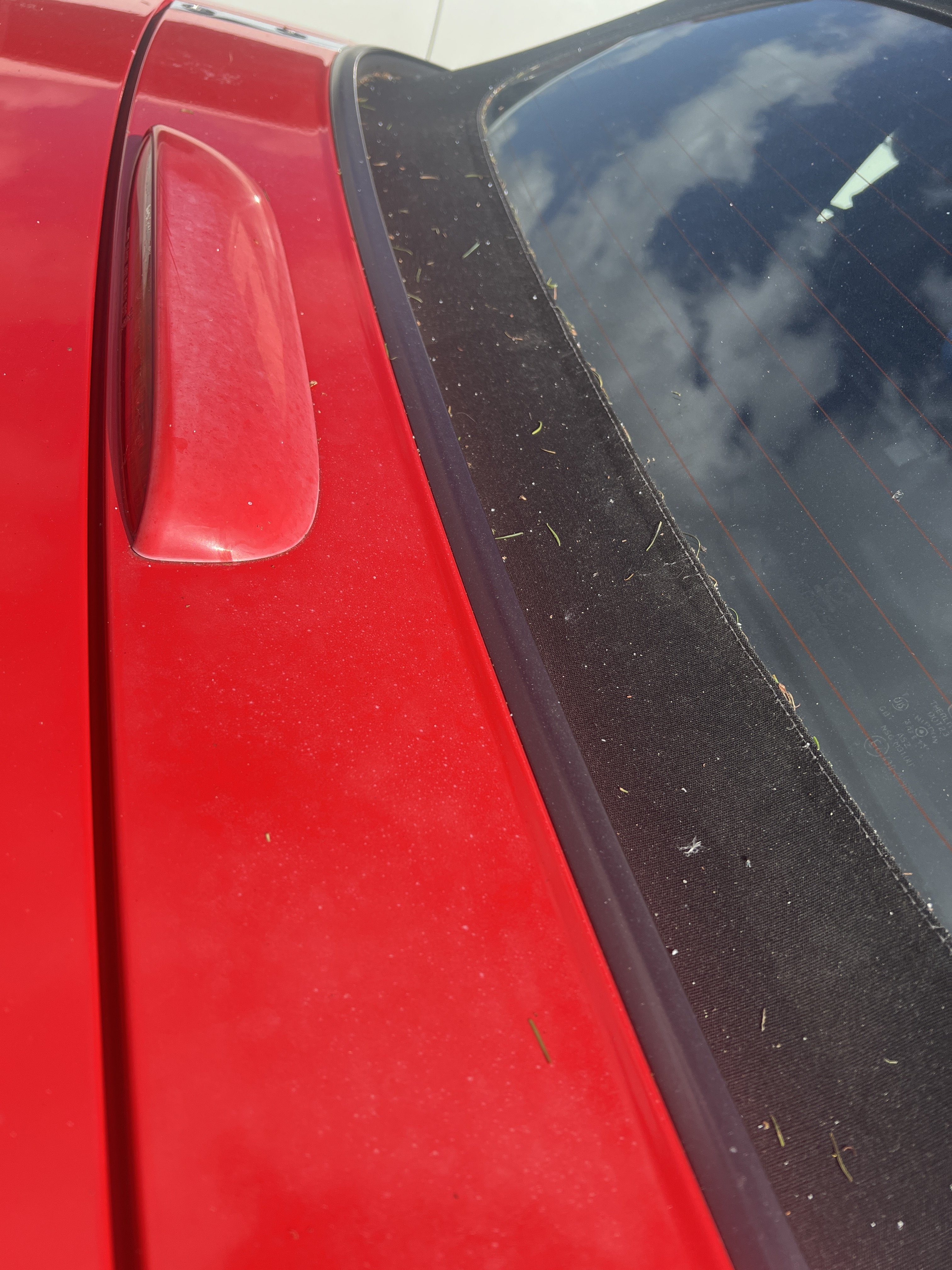

Hi there, new to the group, looking for advice or maybe someone who has gone through a similar scenario.
I have a 2008 ‘True Red’ Mx5, one of my first projects was getting it wrapped. I did a-lot of prep work and had a bodyshop look at my car to make sure the paint was in condition for it to be wrapped and all was good for the go ahead.
A week before the scheduled wrap, I left my car with a friend in his garage to put a full set of breaks on. I collected my car on a Saturday morning and drove it straight to the body shop where it stayed parked up until Monday.
I received a phone call by the Monday afternoon asking if I come by and look at my car as there seems to be some sort of chemical burn all over my car. I went straight away and sure enough on my boot, brake light and the middle of my bonnet there are random splotches where my paint has lightened and started to dissipate.
We tried testing the wrap but as soon as it lifted, most of the paint was taken up with it. I’ve spoken too a few different garages/ body shops who have recommended a bare metal respray but can’t give answer to whats caused the issue.
I have attached a photo but unfortunately it isn’t the easiest to pick up on camera.
Any help or suggestions would be appreciated:)
Over polished and burnt through the paint work during the prep
What exactly was involved with the prep work and what products were used?

I don’t have the exact products used as I had taken it to a bodyshop to save time. The main work done was sanding down parts of rust on the wheel arches and then left with a basic prime instead of re-painting it. The same was done with stone chips and areas of lacquer peel.
The areas that where worked on aren’t close to where the paint has no started to come off which confuses me more. When I picked my car up I went around the car looking to make sure it was all okay and no damage, unless a certain product was out on and took a few days to show, but again why would a bodyshop use chemicals damaging to paint…
