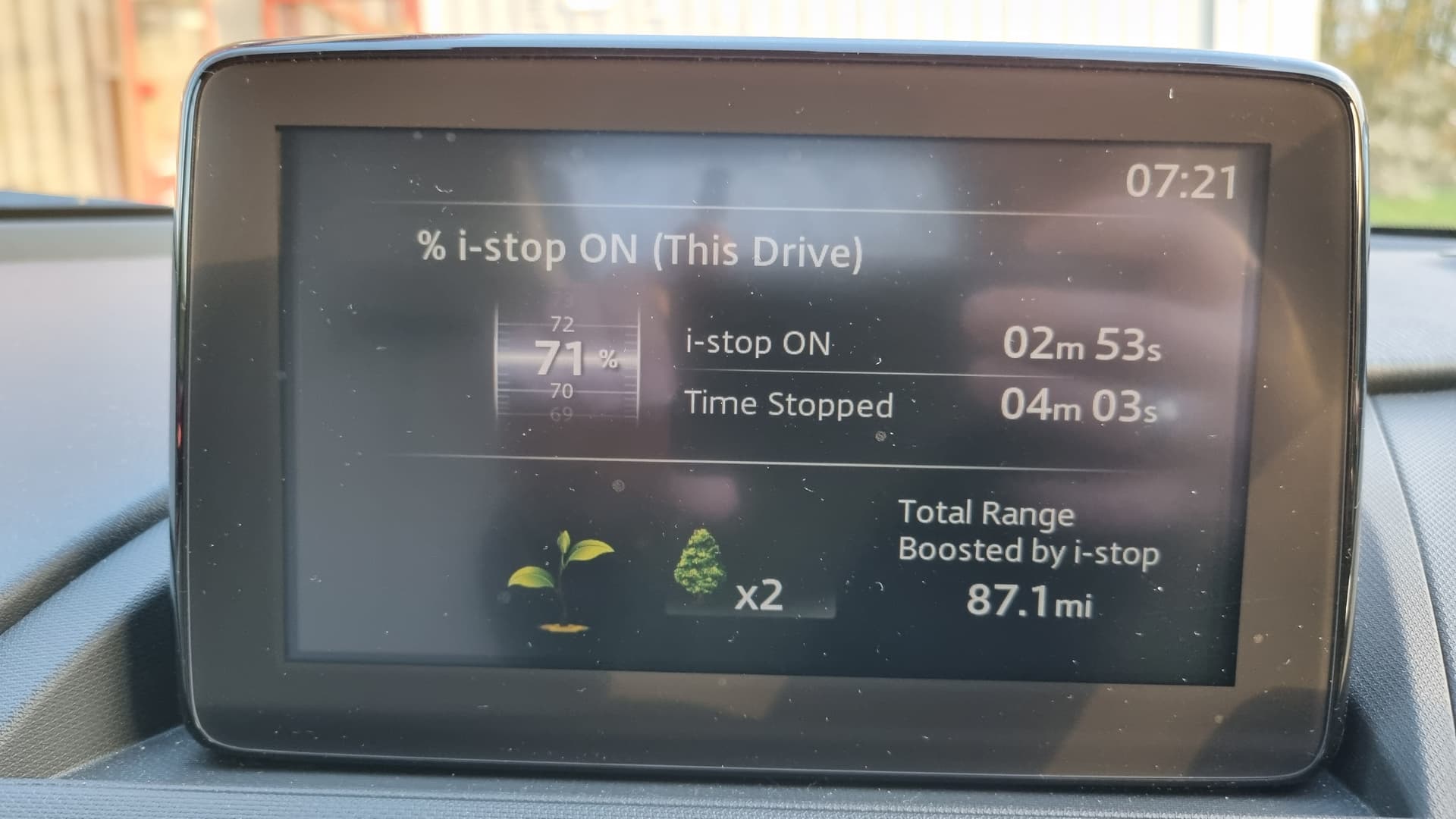

Hi David, go into the fuel economy monitor, then settings and tick ‘Show screen at ignition off’
It then shows the screen below for a few seconds after you turn the car off.
When I first ticked this I thought it would give a summary of fuel used, distance travelled and MPG for that journey, it doesn’t but it does tell you how much you’ve been stopped and how much of that iStop has been on, as well as the total range boosted by iStop. This is a typical commute for me this morning, stopped about 4 minutes, iStop on for about 3minutes. Out of a 30 minute drive.
