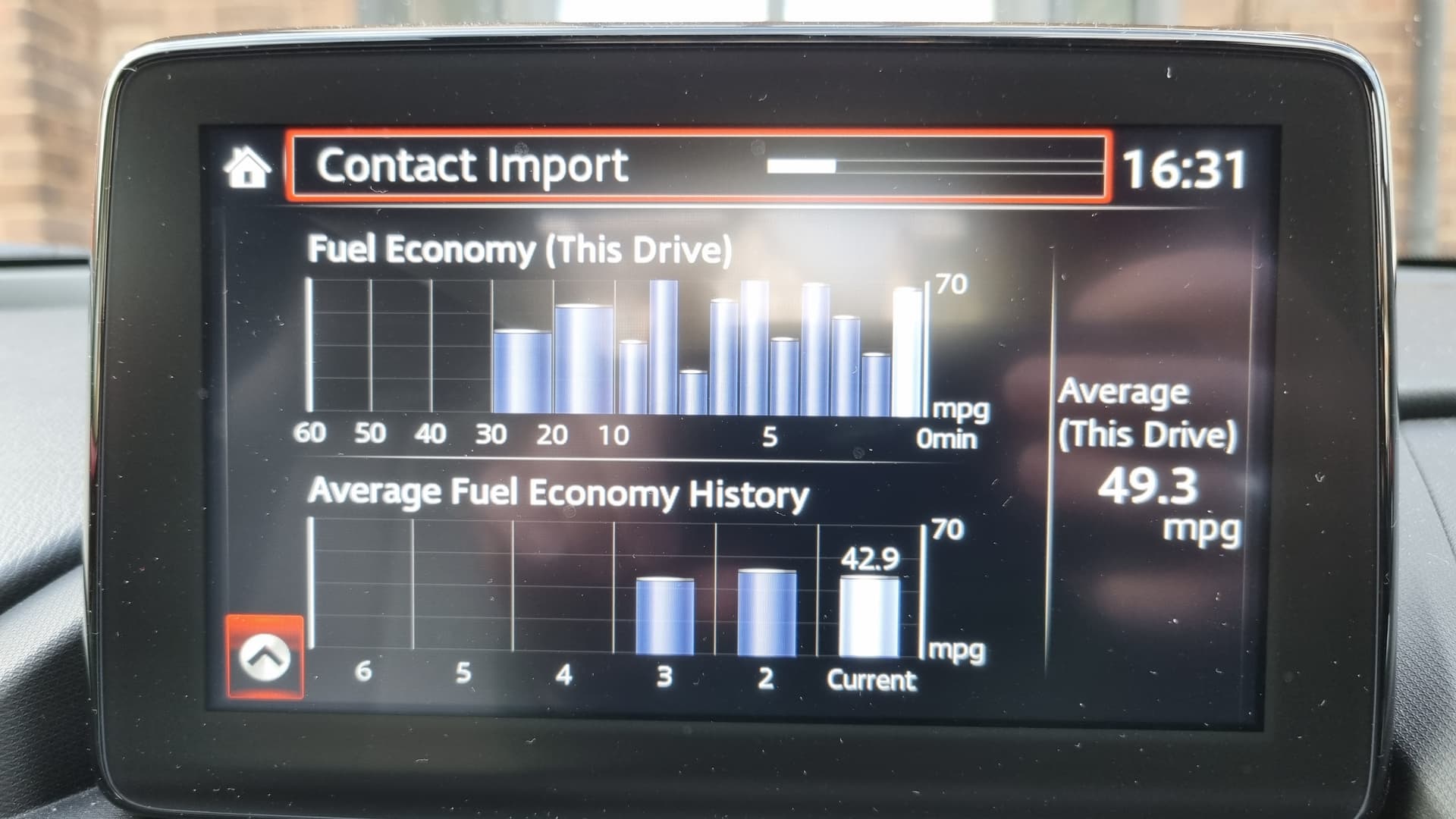

So I found another screen in the fuel economy monitor on the way home. This is more like the type of thing I’d expect to be displayed at switch off rather than the one it does.
Yes, indeed. Talk about blinding with science… You need to carry a ruler or tape measure to measure and read the vertical scales.

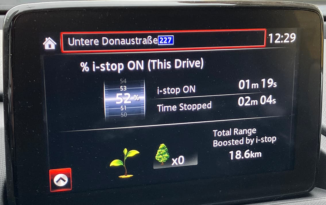

If I understand it correctly, this cute attempt at recommending i-stop tells me that on this journey i-stop had been on for 52% of the time when stopped; and that i-stop had provided me with 18.6km free kilometres of travel over the total course of my travelling since new. I presume that I can reset that to zero somehow, but that can wait for another day.)

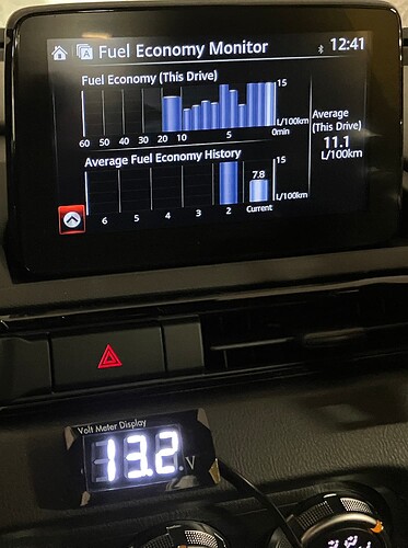

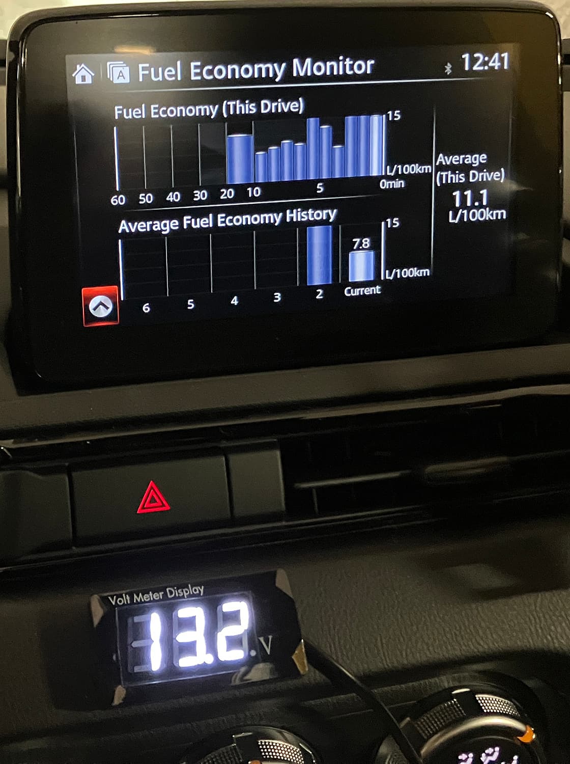

And this photo shows the hard to interpret graph of “mpg” in (litres/100 km) against time. Not a very good result, as it was a short journey in start/stop traffic. There is quite a lot of clicking and wheel turning required to switch between these two displays.
At the bottom of the second picture you can see the cheap, but sufficiently accurate battery voltage monitor that I have proudly installed, as mentioned above.
