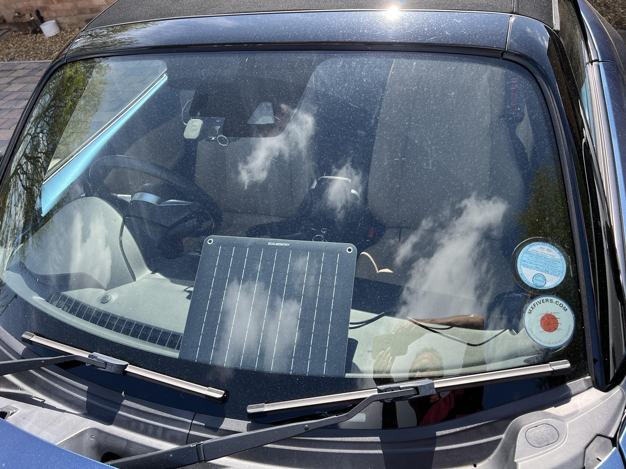

IMG_1424
Here it is fitted for a test within 10 minutes of Amazon delivery :rofl:. Looks and feels like a table mat. About 10” square. Positioning it inside isn’t the most effective, but this was a quick test.
After 30 mins battery voltage changed from 12.28 to 12.29 :grinning:
End of Test One. Results.
Solar Panel was tucked under the wind screen wiper outside (safe neighbourhood) and the lead connected to the battery minder lead (same plug/socket). The panel got full sun for an hour or so and at an angle as the sun moved across the Sky (OK, the earth rotated, but you know what I mean) and then indirect light from about 12 o’clock onwards.
It was left like that for 3 days.
Today I disconnected the panel and we went on a 30 mile round trip. Stop/Start worked as normal, in fact it was working earlier in a journey than usual. No issues at all. I put the battery screen on the display. The flux-capacitor charge was showing almost full most of the time and slowing down/braking charge seemed to be much more effective in keeping it topped up.
I’m not sure if it was my resetting the stop/start the other week was the only cause for improvement but I will attach the solar panel if I know I’m not going to be using the car for a few days. When not in use, it will be connected to Daisy, my Eunos.
I won’t do Test Two yet - connecting to a permanent live terminal in the fuse box further “along” the electrical chain as it seems solar charging doesn’t seem to screw-up the iStop system like the battery minder does.
For cars that don’t have such complex electronics (Daisy for example), then connecting straight across the battery seems to be fine.
Overall, 10/10 as far as I’m concerned. Maybe try a 20w version :thinking:
Great solution for maintaining charge in Summer and at least slowing down the rate of discharge in Winter.
