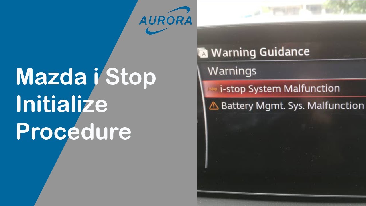

Before, I had used instructions found on the web but this time, it wouldn’t clear the messages so I investigated further and found a Malaysian video that showed step-by-step instructions. Although it wasn’t an MX5 that was being cleared, the instructions are almost the same.
I will post a link to the video below, but here are the differences I noticed.
After reconnecting the negative terminal and waiting 30 seconds before reattaching the sensor, I shut the bonnet (unlike the video instructions). This is because the MX5 has a bonnet switch that tells the car it’s in maintenance mode and it stops i-stop from working (sensible when you think of it, a mechanic will not want to be working on an engine that keeps stopping!).
Secondly, in the video, it says the i-Stop light turns green - on my MX5 it is orange or off. Read “i-Stop off” instead of “i-Stop flashing green” in the video.
Otherwise, it all reset perfectly and a short drive and i-Stop was doing what it should do - whereas using previous instructions I’d found, it could take a couple of hundred miles before starting to work again. I believe the secret of the success of this video is disconnecting the sensor plug from the voltage sensor on the (-) battery lead allowing it to reset.

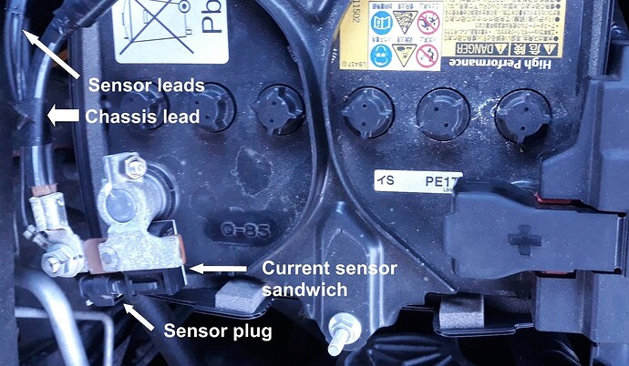

The current sensor connector should always be disconnected before removing the negative battery cable and reconnected after. Leaving it connected can allow it to detect a current surge during disconnection and reconnection resulting in the system incorrectly calculating the battery state of charge.
Okay…I know where that lead is because I saw it when I charged the car with the smart charger. I will gently pry it out before disconnecting.

So followed Mad_Malc, simply disconnected the 10mm main clamp from the negative terminal (ie the entire module incl current sensor module and didnt disconnect the 12mm negative lead …as that was tightly bound with the leads for the Current Sensor).
Reconnected it 20mins later. Switched on car (without ignition) and system said ready incl the Battery icon. That stopped as soon as I started the engine but about 2-3miles down the road came back to “Ready” and I was I-stopping all the way home. The longest I-Stop stopped for was 2mins (before it restarted the engine).
