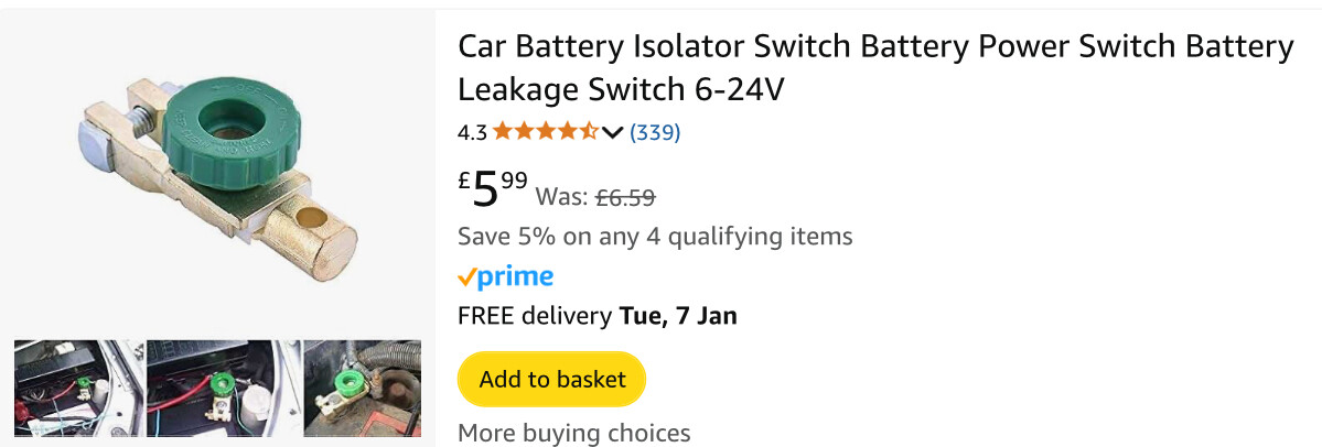

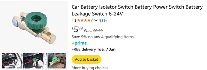

Anyone using a battery isolator to make this more convenient to do? If so what product did you use? The cheap ones on Amazon certainly have a bad reputation.
I use one of the Amazon screw type isolators on my Mk1 and Mk4 and never had an issue. Used if parking up with a 5amp bypass connector to keep radio etc powered up. If someone tries to start with screw terminal removed, fuse blows instantly and car disabled.
Ah thanks, good to know you had no problems. Those are the ones that seem to have a poor reputation!
