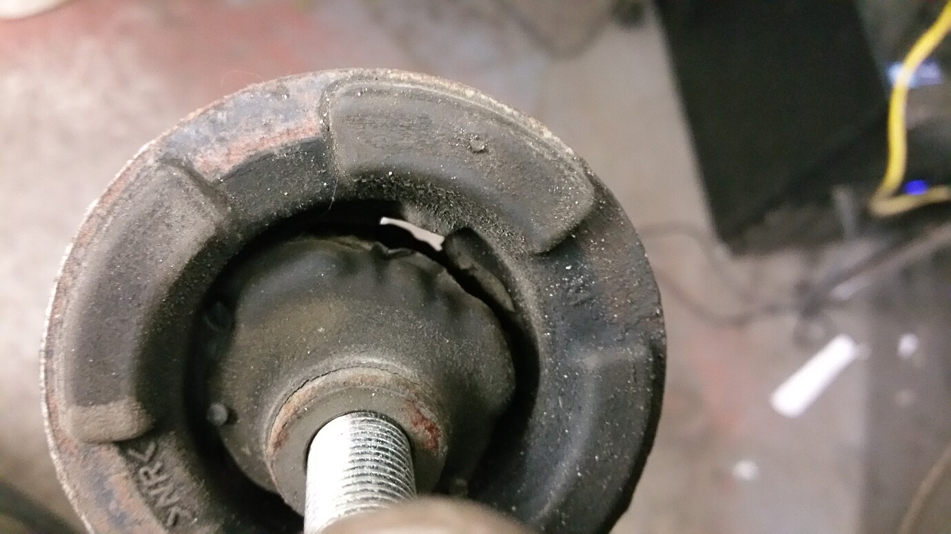

Who was it on here who attached a photo with chewed up diff seals as evidence of why he is doubtful about the wisdom of using the diff as a jacking point?
