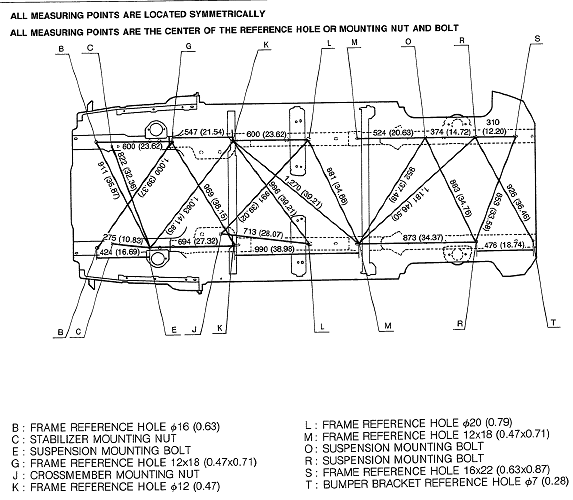

This is a good suggestion @Mad_Malc , though does prompt me to ask; how on earth would I accurately measure the chassis? My heads filling up with bits of string from header rail to… err? lol
Though now I’m thinking tight string lines between key points (tbd) and if I see any sag in the lines enable panic mode?
If the shell is good and the sills are solid then I would not overthink this. Go for the top of the door apertures on both sides, pop some ‘indelible’ marks on and measure. Just two measurements to keep an eye on so not too onerous and you will sleep soundly.
