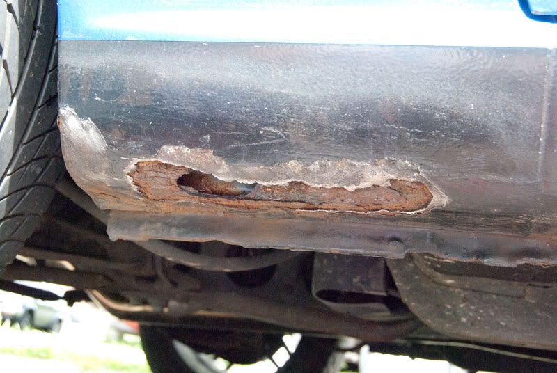

OK here we go. Saturday morning I decided to attend to the “surface rust” that had been on the offside sill of the wife’s 94 NA for a couple of years. After jacking up the car, initial digging made me realise it was rather worse than I had anticipated, and I was left with this:

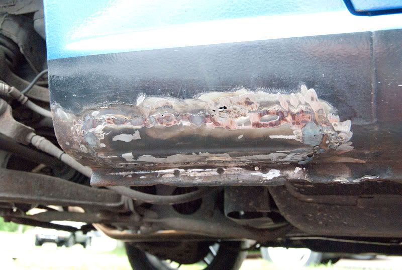

The inner sill was fine and after an angle grinding session, (I ground and cut out all of the inside rust, as far as I could get at it) it was out with the welder and get my neighbour to plate it, after grinding off the excess weld we had:

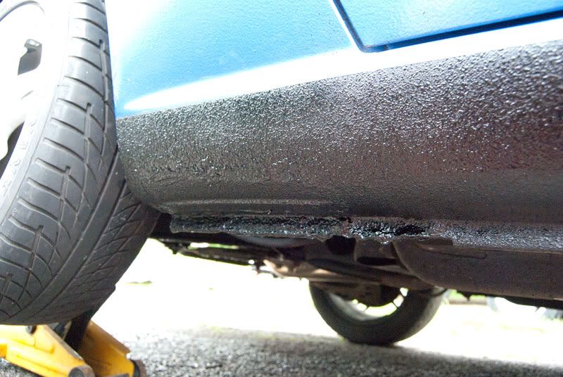

painted in zinc primer, then seam sealant and stonechip guard, followed by a final coat of shultz, and we had this:
hardly noticeable as its right at the bottom of the sill, only remaining job is to drill a hole from the wheel arch into the sill to get some waxoil in there. Curiously the nearside rear sill shows no rust whatsoever…
