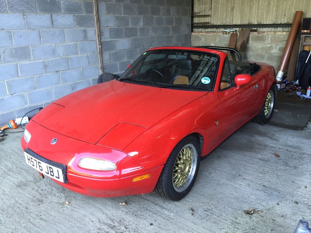

just finished my supercharger install

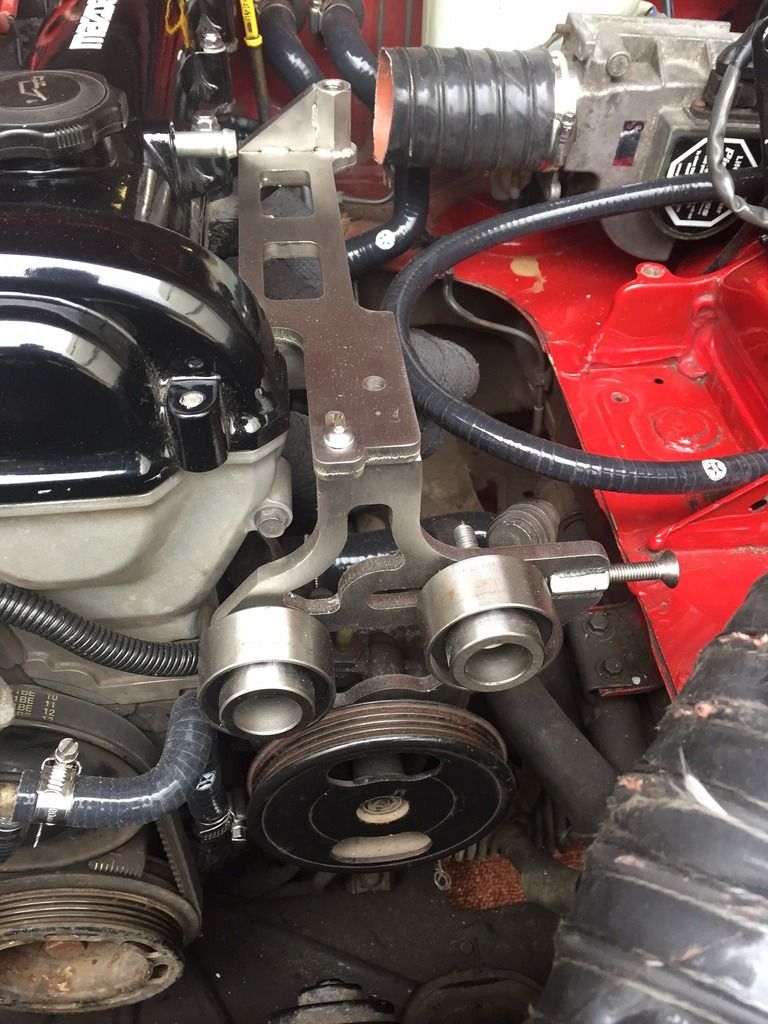

The final production Bracket set is on its way to us now…  It will be a cracking piece of kit in brushed stainless.
Gaz
I received the final production bracket on Friday, so i thought i would put a couple of pics on here.
I will be ordering the first batch today so should have them in a couple of weeks.
Well I have been to the Dyno.
As the people who have been following this thread will know, the intention was to see if we can produce a very simple supercharger set up.
Basic Spec.
1.6 Eunos with 80,000 miles on it.
Salon Motorsport Bracket/Tensioner.
Salon Motorsport M45 inlet.
Salon Motorsport M45 Outlet.
Variable rising rate fuel pressure regulator.
Standard ECU
Standard size Pulley
No Intercooler.
Rather Then building a car with all the bells and whistles, We wanted to initially build a car with the simplest set up possible, I even removed the cold air feed airbox and replaced it with a simple cone filter for the dyno.
The higher spec one will come later, although a couple of people are going to beat me to it.
I,m Very happy with the results… A Big thanks to the chaps at SANSPEED. Being the simplest of setups it only cost £150 for the work.
