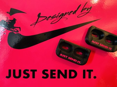

I know many of you probably know about these but for those that don’t I can honestly say that these have been the best mod, bang for buck that I have ever bought.
I did need to sand one end down slightly for a perfect fit, but for just £14.99 they have made a huge difference to my MK1.
Never did i think that a simple set of door bushings would make such a big difference to the refinement of the car. Shakes and rattles have been greatly reduced and the car just feels ‘stiffer’.
I’m now thinking of getting some Jass chassis rails as well…

Are these the rubber things which sit in the door shut ?
If so then they are inter changeable between sides.
If you believe that they are worn, swap them between sides.
Its not about them being worn, although this obviously does not help. It’s about the movement you get with any rubber bushing.
These are plastic so a tight fit and no movement at all. Even just shuting the door the car sounds more solid.
At £14.99 they are well worth fitting.
