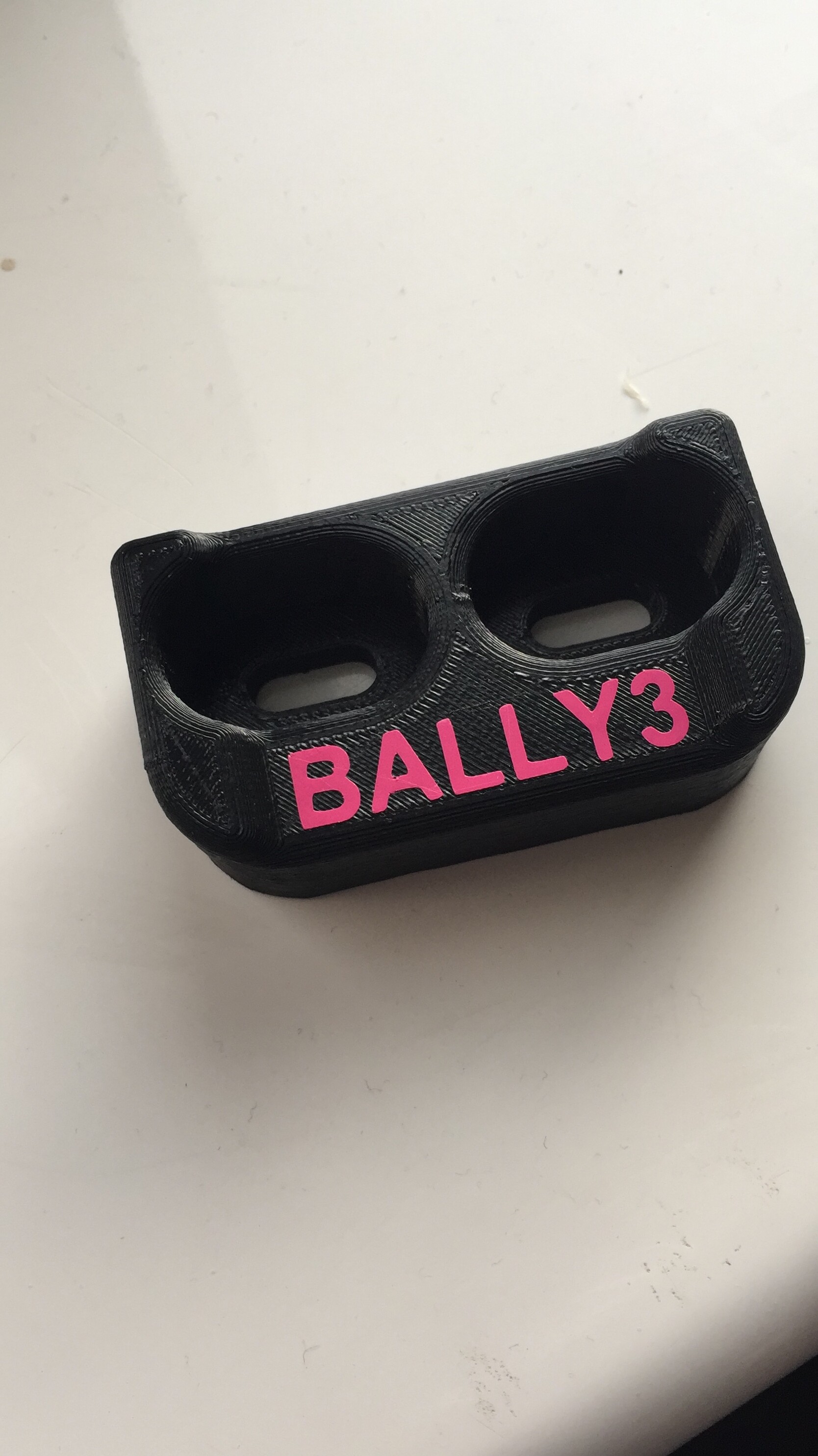

Theyre not beautifully made though and appear to be 3d printed.
They come oversize and need sanding to fit but once done, all the creaks and groans from the folding roof disappeared and the car does feel more confident and less squirrelly.

Back in the thread a fair way I mentioned I’d 3D printed a pair of these and thought there was a general improvement in the feel of the car after fitting and left them on. After that, a few of weeks ago I had the Eibach -30mm coils fitted (and full geo setup) and have got used to the more direct feel of the car.
When I first fitted the printed door bushes I was aware they were not tight in the cups; not loose, but they slid in without sanding so I made a pair .3mm wider and could feel these were a quite solid fit to the sides of the cups. I did a (roof up) run over roads I know well including our far from perfect approaches to the village and the result was the ride felt the same but there was a lot of squeaking and rattling from the roof I didn’t have before; quite unpleasant.
I then gave my original rubber bushings a good squeeze in a vice as suggested by Saz9961 somewhere up the thread. There are signs of contact on these but no visible wear. When I drove the same route the rattling had gone and the ride felt smoother on the rough surfaces, riding better over the irregularities.
Going back to my original printed pair, these seemed to be a half-way house. Rattles on a rough road were gone but there was a greater feeling of the road surface transmitted through the body than with the OEM rubber bushes.

All in all, I find the bushes do live up to the claims but in hindsight, I think I should have gone for the Cobalt delrin bushes rather than the ABS 3d printed ones and I still might.

Now I’m convinced that they actually do work as claimed, I’m definitely tempted to ‘buy twice’ and get a pair of the Cobalt Delrin bushes from Moss. The ABS 3D printed ones are showing signs of scuffing.
I printed these in PETG which is a modified version of the plastic used for most fizzy drink bottles etc.
Very similar properties to ABS but a lot easier to print with. ABS is what Lego blocks are made of.
Delrin is a more resilient than both these and a machined block is always going to have better wear resistance and dimensional rigidity than a 3D printed bushing.

The 25 is fine but the 8 is not for such small items, so I got some machined Delrin bushes from a guy called Rob Bate.
Great quality and the same 25 quid but no postage charge and you get stainless flanged bolts thrown in.
Buy cheap buy twice for the just send it version but I was sceptical if they would work.
Now I know they do, Rob Bate is my recommendation.
I didn’t realise I had ordered pink lettering :flushed::flushed::rofl::rofl::rofl::rofl::rofl::rofl::rofl::rofl::rofl::rofl::rofl::rofl::rofl:

Don’t you fret now. They are lovely darling. :heart_eyes: :lips:
